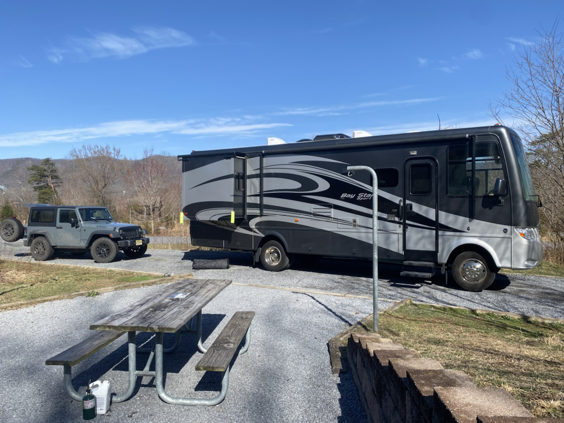

I'm sure you've seen the news about the guy who flat towed his Jeep, leaving it in 4LO and 1st gear. I was actually towing mine to the Shenandoah valley when the story broke. I always triple check. I first make sure that when I put in D, it won't go forward. I check that the 4wd light is not on. Then before hooking up the tow bars I make sure the Jeep can roll back & forth. I have learned in my 2014 that I don't need to leave the key in the ignition, even though the manual says to do that. At some point the jeeps stopped using the steering wheel lock.
