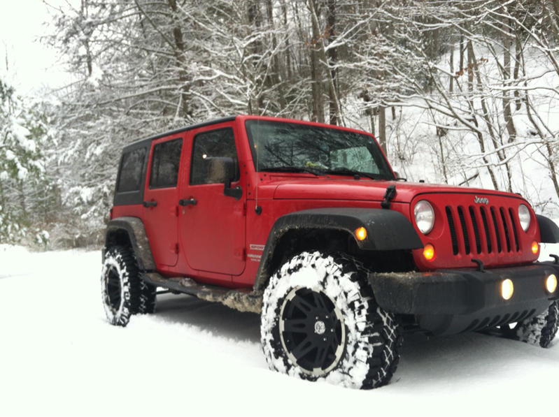

If your needing a quick fix for a lift, Tera flex offers a puck leveling kit wich is what I'm running now. I've had it over a year and have no problems. I only paid $115 for it. I am wanting the 2.5 aev lift though.

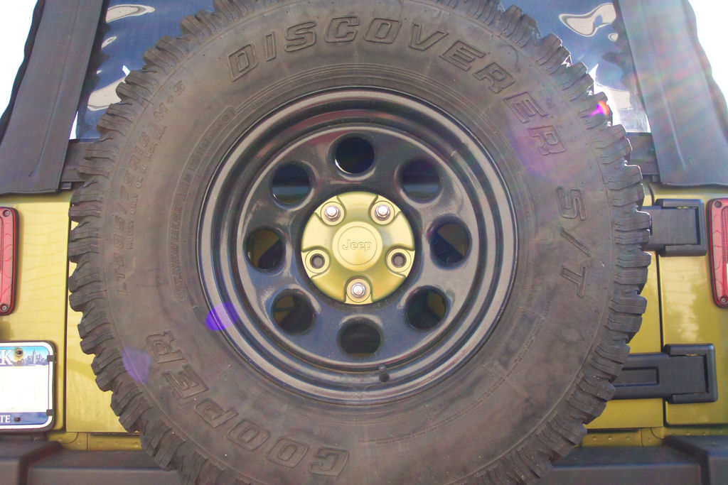

I found an inexpensive option was Cragar Soft-8 wheels. They are steel wheels, have the correct backspacing, and usually only run $50-60/ea.
Here is my old 2-door with Cooper Discoverer STT 285/75R16 on the Cragar wheels and stock suspension:
A nice way to jazz up the Cragar wheels is to paint your stock center caps body colored and add them to the wheels.
Then add a lift later on, if you want.
*sigh* I still miss that Jeep!
