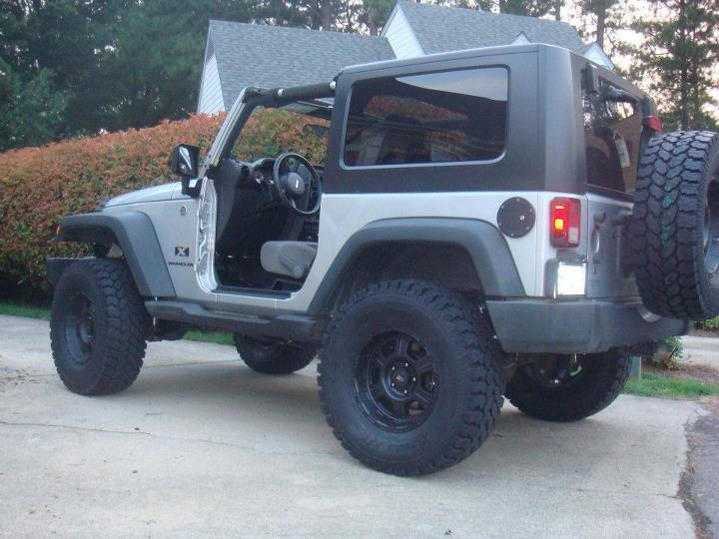

Couldn't be happier with RK 2.5" with 35"s. complete bolt on. Nothing HAS to be done immediately.

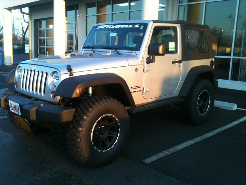

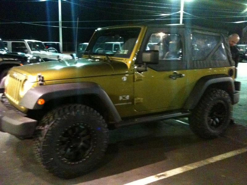

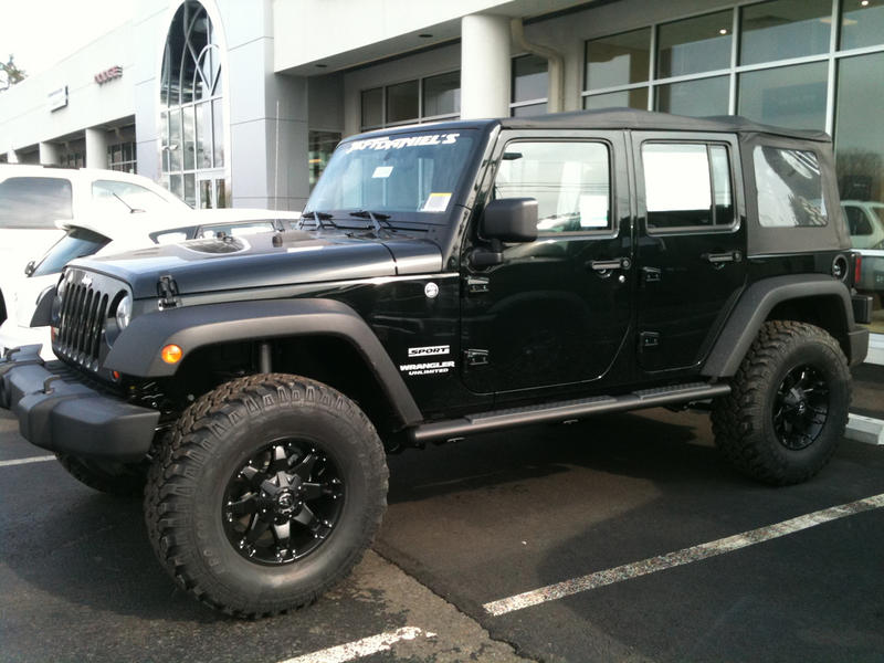

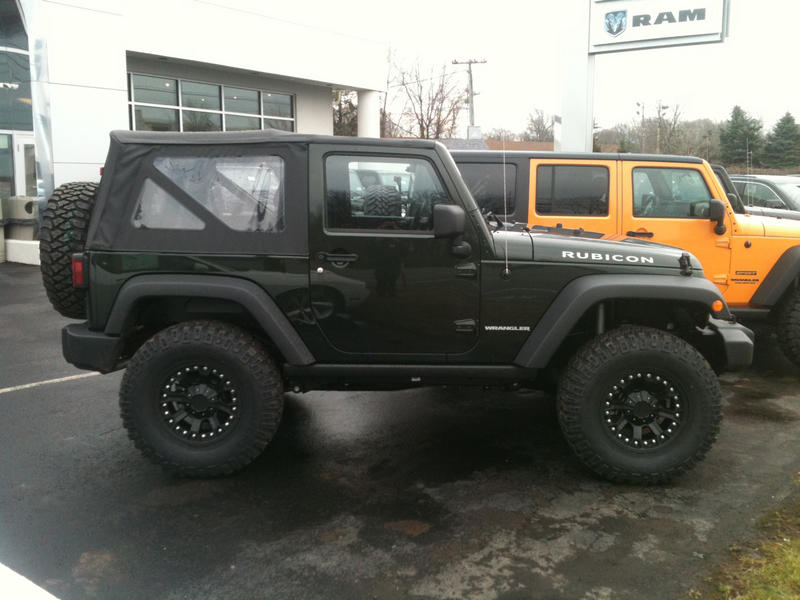

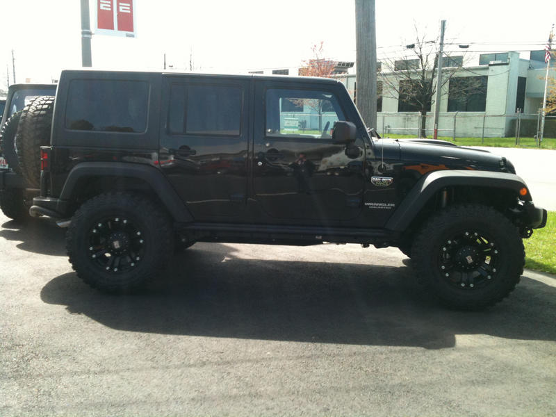

I use to do this as a job at a jeep dealership. (designing 2-3 brand new jeeps a week). It was awesome. But, here are some tips:
Anything over 33's you need a lift (anything other then a rubi 33's might even rub the plastic air dam). You'll see how close your 35's get to your rear rock sliders even with a lift.
We used a rugged ridge 3.25" lifts ( highest you can go w/o drive shaft alterations) seemed fine although I never ran it off road.
When looking at your 35's remember on the road you are going to get a little rumble when starting from stop and slowing down depending on tred. Being more of an everyday driver may want to look at BFg a/t I run them in 33's on my 12 rubi and they are awesome (street mud dirt sand snow). I know I am going to get arguments from strict trail riders but all in all you get the best all around tire for the money.
Wheels get at least a 9" wide wheel w/ 4.5 back space. Your tires will wear better on the street w a wider wheel. Don't get wheel spacers, they are a bad idea.
Sell your old stuff on craigslist you'll get more money then you think for wheels tires and stock suspension parts, people are ALWAYS looking for them.
Post pics when your done!!
Here are some of my creations - enjoy!!!

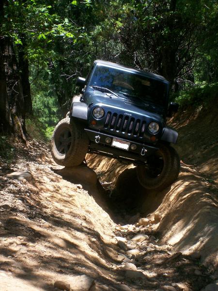

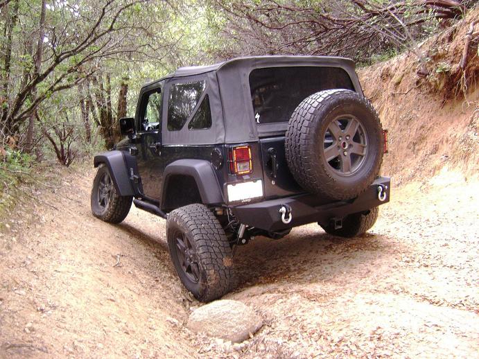

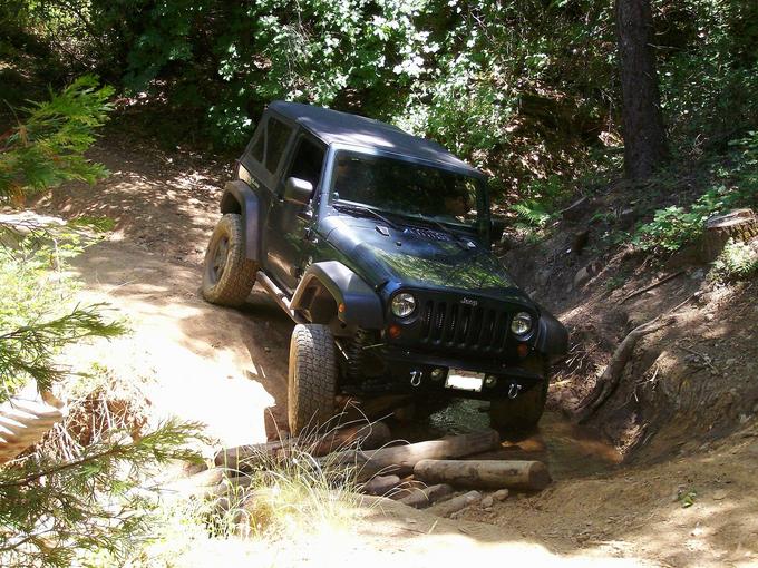

Running 3" lift with 33's(295/70/17's). 1.75" spacers on OE Grand Cherokee wheels, Perfect for all around road/offroadClick image for larger version
