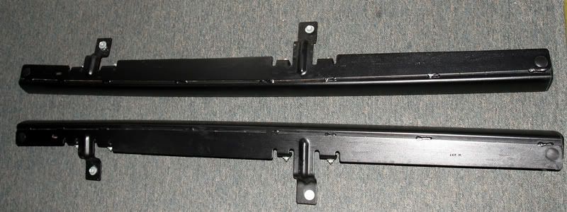

It's true, if modey is an issue, pick up a set of used factory Rubicon rails for now, and after you do your other mods, pass them onto someone else and get the set you really want. The factory ones dont look strong but they have held up nicely according to many guys running them.
Here they are. You could probably pick up a set for $100-$150.

I got a set of the stock rubicon rails for a steal of a deal from a local forum member and can say that they will work great for most folks. My first trip wheeling I dropped on them a few times and they saved me from damage that my other steps would not have handled.
My only complaint on them is that they don't have a bar for additional protection and to allow my wife/kid to step up. However, Woods is talking about offering a weld-on kit and I'd consider it as a nice upgrade. Now I just need to butter up my brother-in-law to use his welder.
