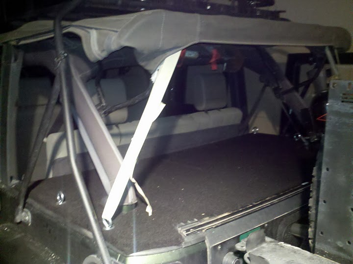

Here's my shelf, second version I've done. This one based off the one that Robar posted the link to. It's very secure and once I figure out how to lock my back seat, I can place stuff in there with no risk of it being stolen.
Attachment 111917
Looks like you put alot of thought into this. Job well done. My problem is iam lazy and need a bolt-in.....

Crappy cell phone pic disclaimer.
From the rear, turned out grainy.
From the front
This is the rear mount to the sport bar. It is rainy and overcast here today so I used a flashlight to shed some light.
