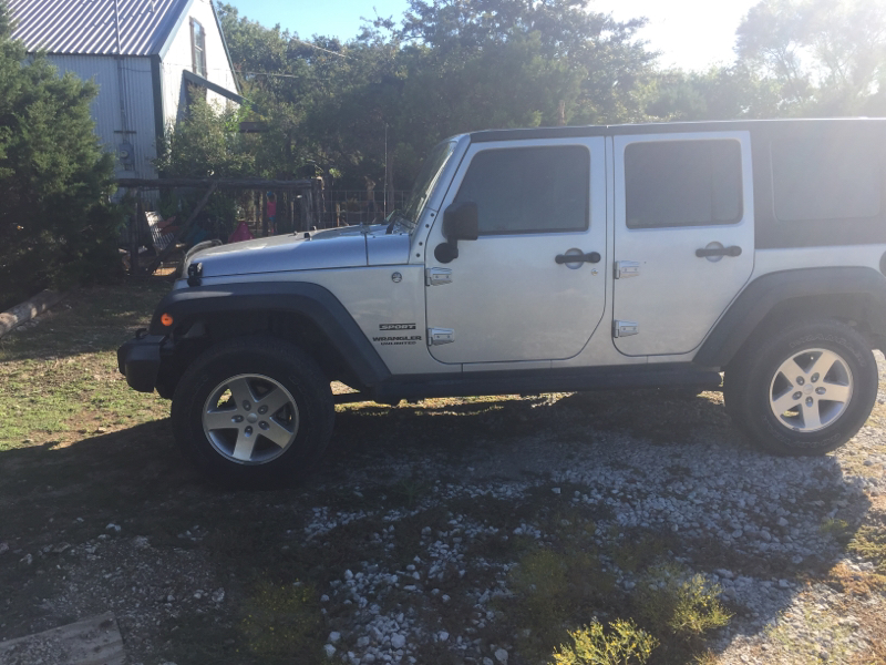

I know it doesn't have much of a lift if any, but can anyone tell if it is from a picture.

Looks like possibly a 1inch spacer lift. Also maybe just small tires that make it look like it has a gap between the tires and fenders. Hard to say without knowing the tire size.

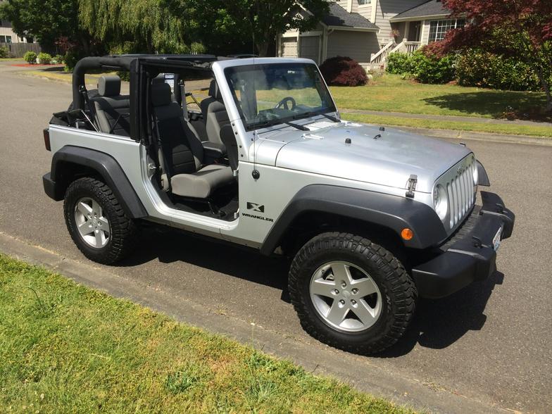

This is my old 2009 2 door with no lift. Seems to have a little less gap between tires and fenders. I would say that one has a 1 inch spacer lift or leveling kit if anything.

It has stock 255/75/17

It has the factory highway tires a Sport comes with which is why it looks like there is a lot of space. I would say that it does not have a lift judging from the rake of the Jeep.

Could possibly have a leveling kit, check for a spacer above the front coil or see if it has extended sway bar links

Idk, from the picture at first glance I'm gonna say not lifted but knowing a little bit it could have a slight lift.
