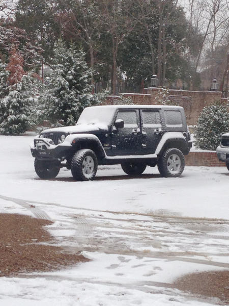

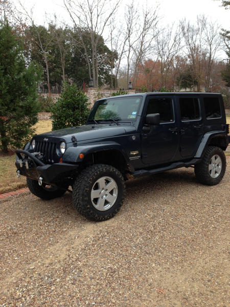

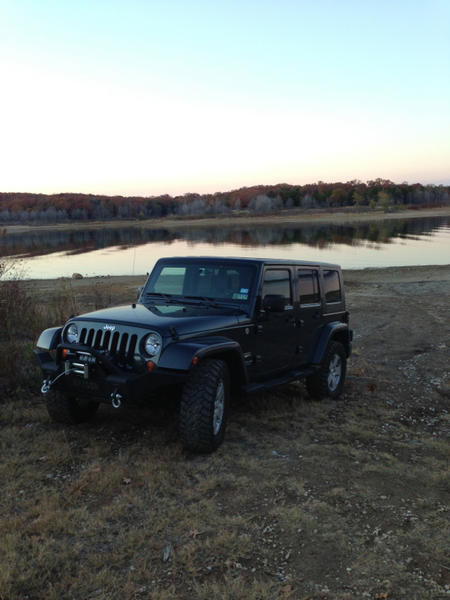

I know there are other threads out there but I can't find them all and I want opinions based on the mods I have.
Currently I have a 2008 JKU Sahara.
I have 33" tires (soon to be 35")
4" of full suspension lift
Front bumper and winch (telling you for weight purposes)
I want to re gear and I'm thinking 4.56 or 4.88?? Opinions please?!?
Last pic is before the lift
