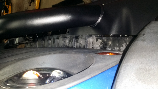

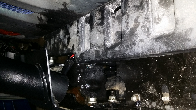

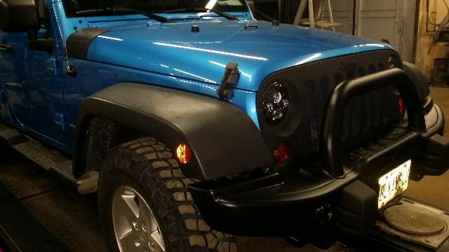

Some picks of the gap between bumper and grill and oem trim panel that sits 4-5 inches lower behind the rear edge of the bumper. Any one no if this is normal?
Yeah, that looks about right. When I look at mine from that direction I can see that gap. The trim panel is more intended to hide the gaps when looking at it from the front.
Here's the only pic I currently have which shows part of the trim piece. Since, I installed a winch I had to trim the trim piece according to the instructions.
Also, I seen someone who took the winch delete plate and trimmed it down so only the clutch handle was sticking out.
I just put a neoprene winch cover over my winch which wouldn't work using any part of the delete plate with a winch installed and you'll want to cover your winch if you use synthetic rope, as well as be able to remove that cover.
For fogs, I just re-used the OEM fogs for now until I go to LEDs. Any fog that is intended to be an OEM replacement should work on the AEV bumper, since that bumper uses the OEM fog lights.
Thx for the info I'm glad the gap looks normal
The gap is normal for the newer generation AEV bumpers. Mine is flush with the grille since I've had it since 2009. My best guess is they changed it so you could change headlight bulbs without dropping the entire bumper.
