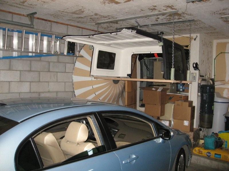

https://www.jk-forum.com/forums/show...hlight=removal
I built one of these and it is super easy to take the top off by myself.
Old Aug 27, 2009 | 09:29 PM
AZJeeper's Avatar
Super Moderator
Community Favorite
Joined: Sep 2007
Posts: 1,734
Likes: 83
From: Arizona
This works well for me. Very easy install/removal. There's a few threads on this forum on how to build something similar. Look for "Hard Top Hoist"
