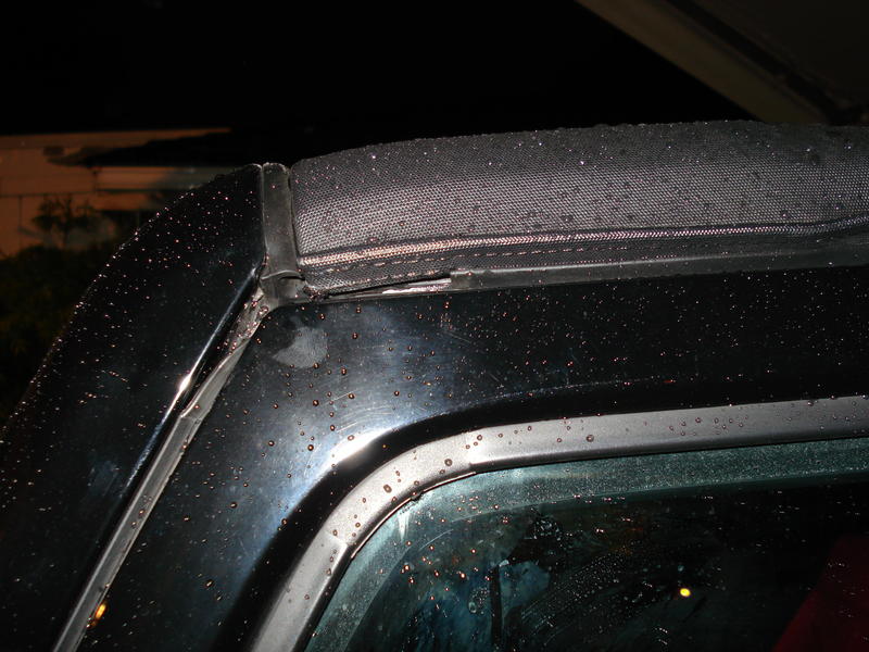

Okay, so I feel I can go almost anywhere in my JK with one exception, just like the wicked witch, the rain seems to melt my Jeep.
Hard top on- open the front door and it's a piss like stream of water onto the front floor. Soft top- the meeting place between the top and the frame leaks almost non stop. I've driven through high surf on Pismo Beach ,but a little rain!!!
ID:	111211Click image for larger version

It looks to me like there is some pretty serious damage to the rubber gaskets. That would certainly let plenty of water come in.

Ok, i just looked at the raingutters. Theres 2 main problems:
1. The point where the freedom top meet with the frint windshield, the raingutters can't extend any longer, so they end where they do and drip inside. Lets say this one is hard to solve.
2. The raingutters (on the front panels) are blocked on both ends, so they fill up with water and, because normal vehicle inclination is slightly forward, it falls from the front end. They have to let the raingutters from the freedom top panels connect to the raingutters on the hard top so water con go to the back of the top (because it will still be blocked on the front end, and the back end of the raingutter on the hard top, above the rear door, is open on that end).
