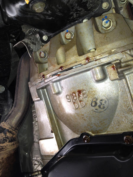

Looks like I might have a leak. This is after being parked for 10 min

I just heard back from Jeep and it is a leaking oil pump, covered under my extended warranty so
I however have a question, they said that they need to drop the transmission, and in order to do so I need to remove my rock rails (LOD) which are bolted + Welded on there. Again, I dont know what is what, but wouldn't they be able to work under the Jeep with these being on there? Or do I have to weld and unweld them everytime things are going wrong????
