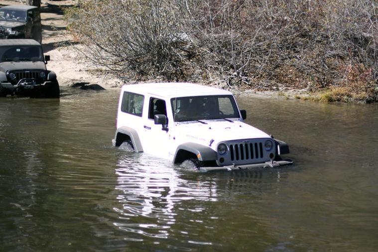

I have the 3.6. Rain and water crossings, no problems to report.

Had water up to the lower door hinge. Water barely trickled in but not enough to get the carpet wet.
