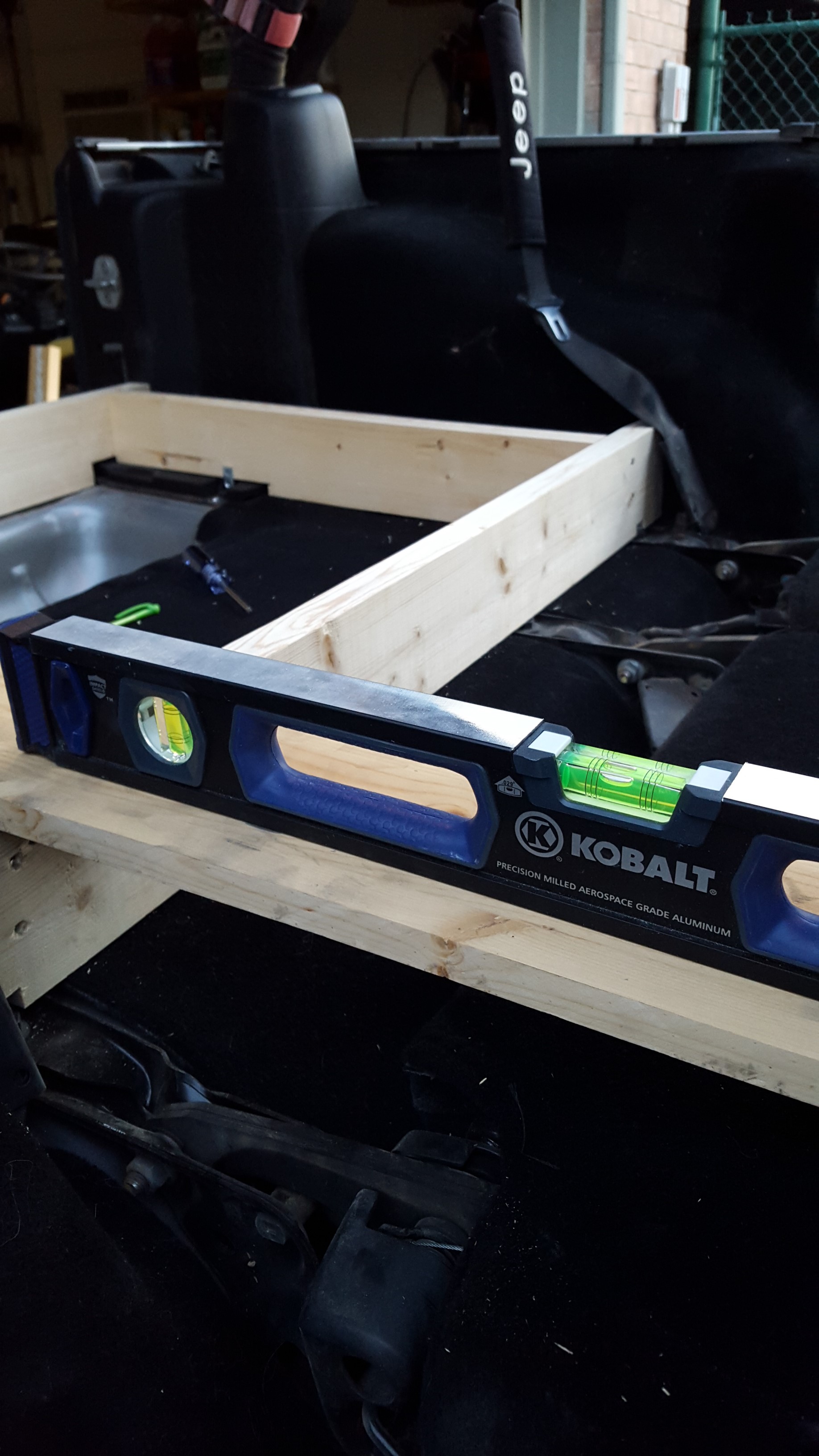

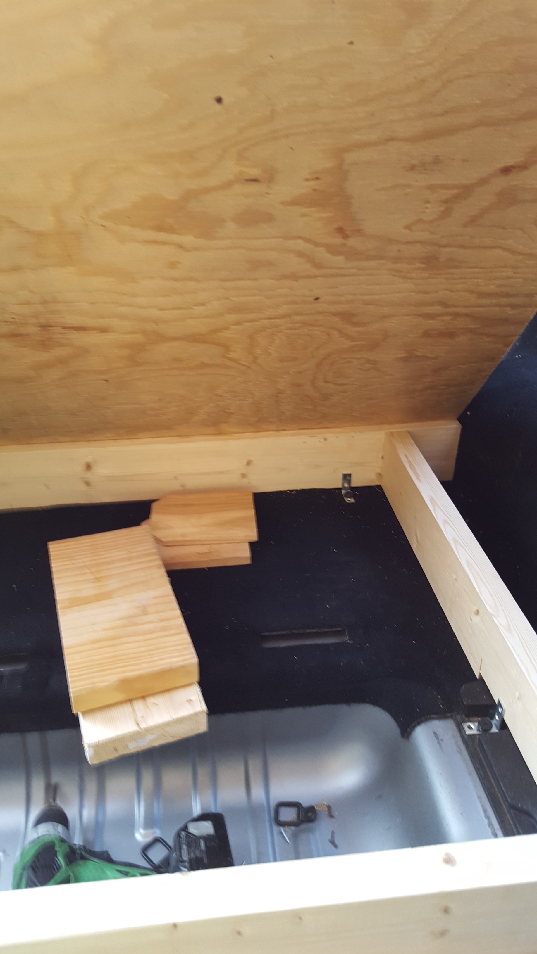

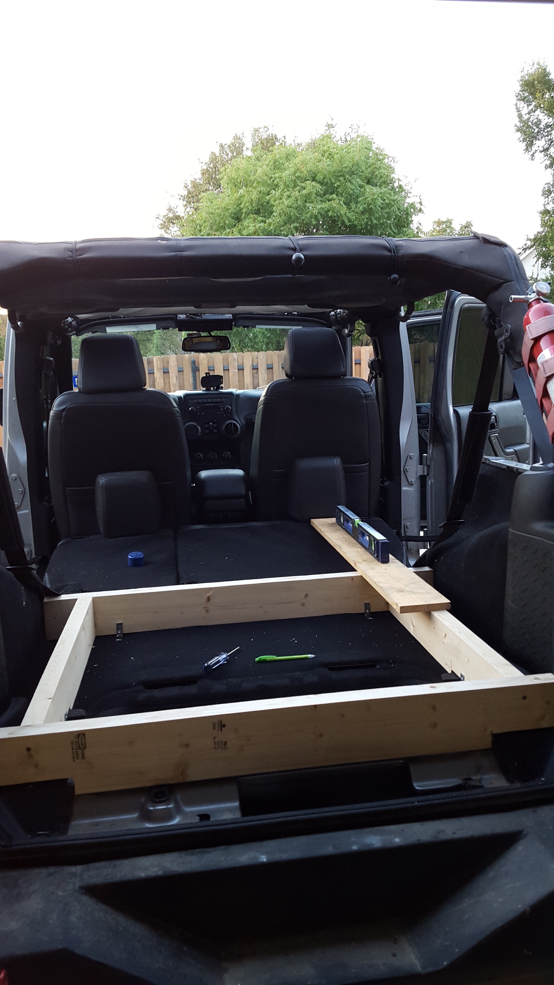

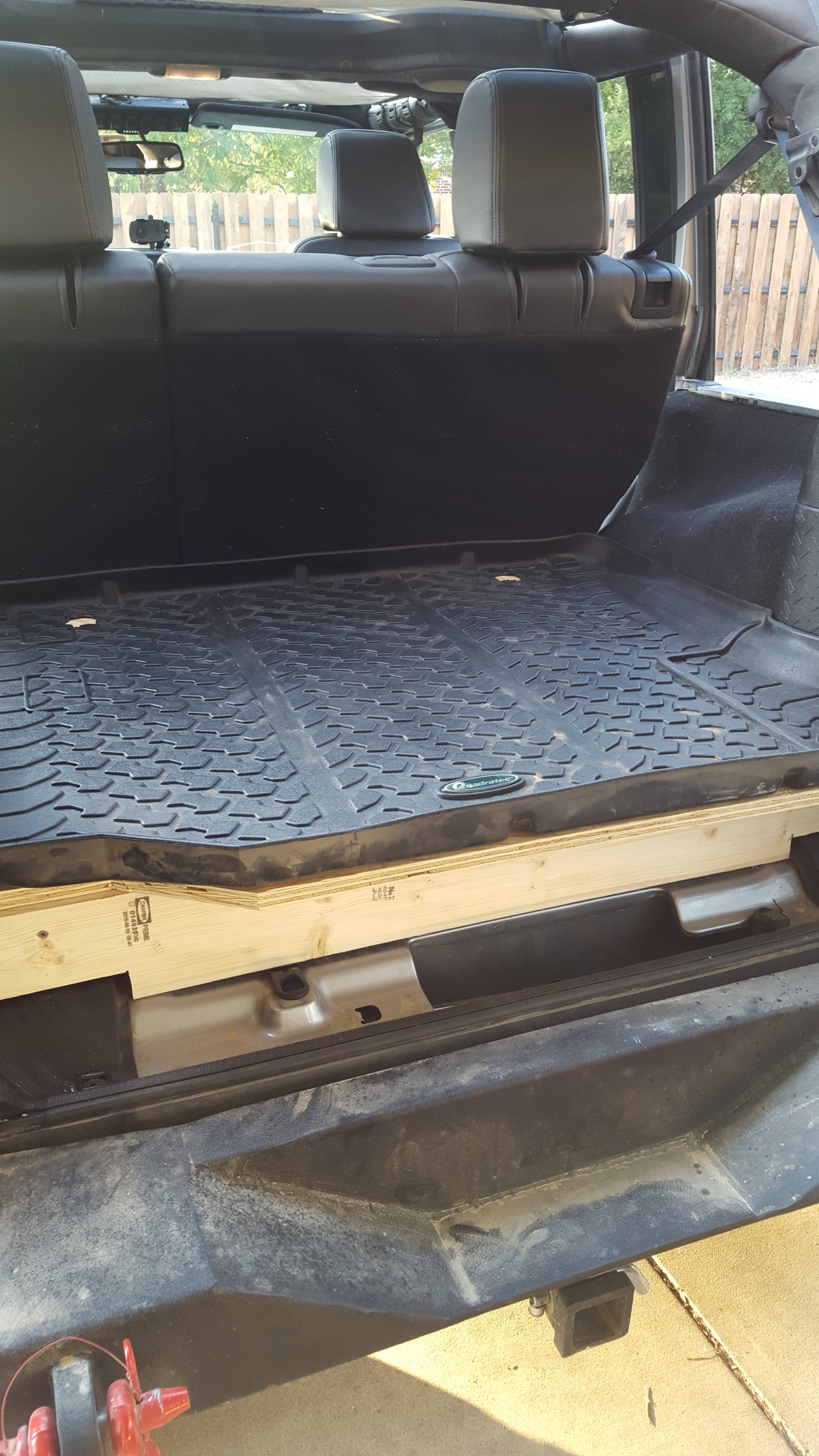

I had a friend that used ronjenx thread (linked above, and thanks!!) and made one out of 2x6 and plywood. I thought it was gonna turn out like crap, and instead was really impressed....so much so that I made one myself. 2x6 was a bit tall for me, so I shaved an inch off. I think I have maybe $80 in mine for 2x6, 1 sheet of plywood, fabric to make it look purty, and spray adhesive to bond the fabric. It is by far one of the best mods I've done as it holds all my tools for wheelin', and provides a flat surface for a quick overnight camp during a trip. I used the 4 original tie down locations so didn't even have to drill a hole in the tub.
Mine would be better made out of metal stud and some diamond plate, but they plywood has held up good for a couple years now, and has even weathered a few dousings from being caught topless in storms.

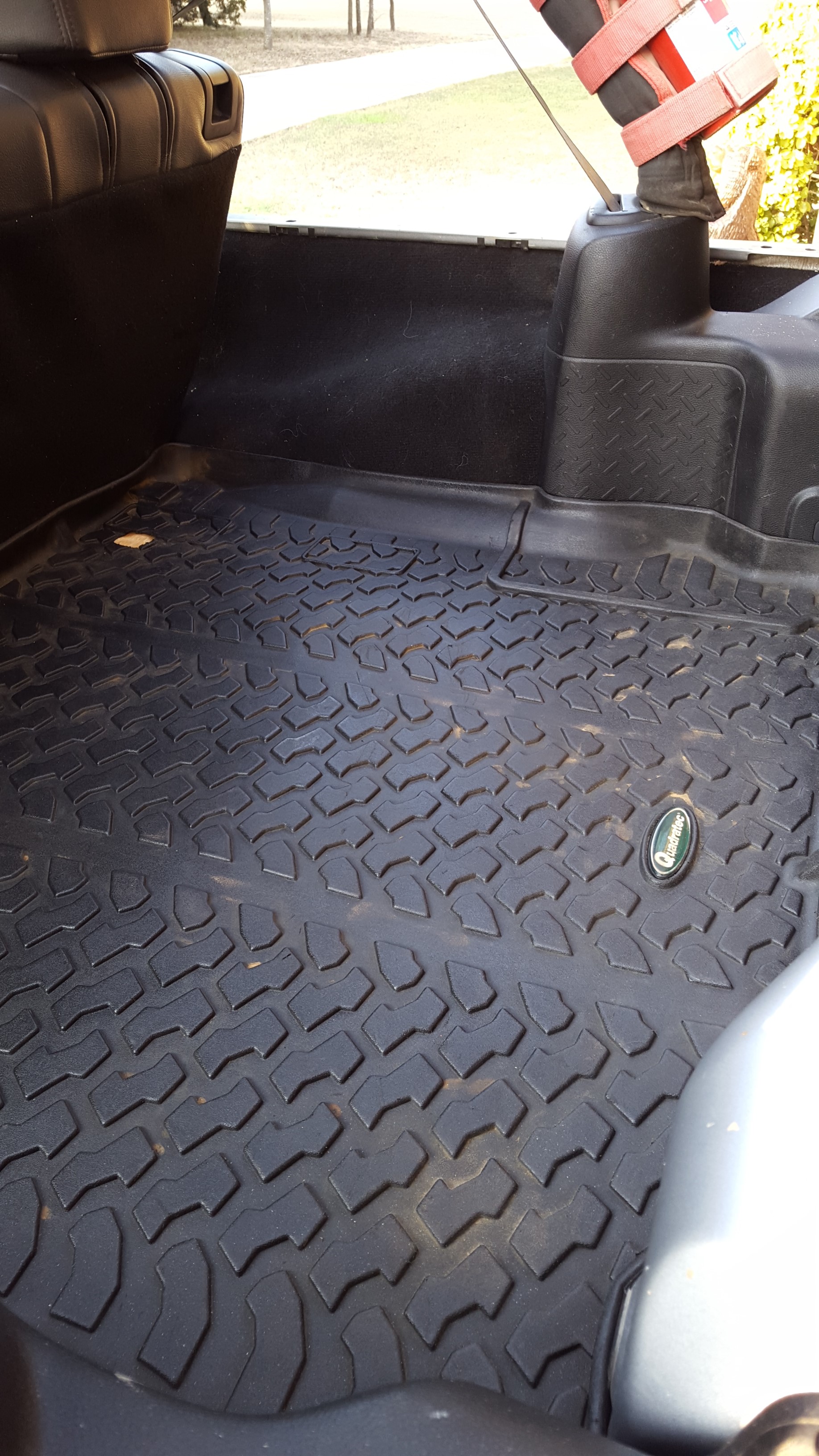

These aren't great pictures, and by no means a nice write up like ronjenx, but here are a couple shots along the way of what I did. I'll try to take a few pictures of the final product tonight and slap em on here. It is as nice as some $600 storage system....probably not, but it works great for me. You can see the 4 places I used "L" brackets to bolt it to to the original tie down locations. I already had a quadratec mat for the rear which actually concealed the whole thing even more.
