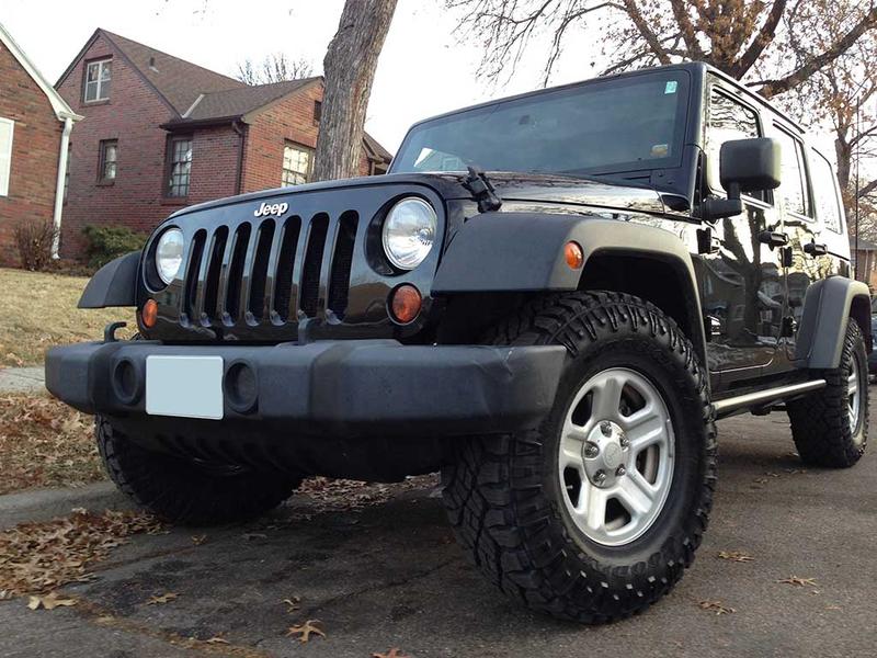

old: BFG AT KO 265x75r16
diameter: 31.8", width: 10.5", D rating, weight: 54lbs
new: Goodyear Duratrac 285x75r16
diameter: 33.1", width: 11.3", E rating, weight: 54lbs
The Jeep looks a LOT better now with these Duratracs. They are only about 1.5” larger in diameter and just about 3/4” wider than my old tires. But what a big difference in appearance!
First thing I noticed is the the rubber compound on the new tires is noticeably softer than the old tires. I’m sure this will affect traction and wear.
The ride is a tiny bit softer now, I suspect because of the larger diameter and more tire wall as well as the softer compound. Under 45mph, the road noise seems to be the same. Over 45mph, the Duratracs are a little more noticeable but not bad at all considering how aggressive the tread looks. The steering is slightly heavier and I can feel the vehicle lumbering a little more to get going. But still, it’s very manageable and not bad.
On snow and ice there is definitely more traction than the old tires.
At full turn, the tires do have just a tiny bit of rubbing on the plastic air dam. It’s nothing drastic so I’ll trim this once it get’s a little warmer outside!
It’s now in the middle of winter here in Nebraska so mileage will be off because of the winter mix gasoline. But at interstate speeds of 75-78mph, the mileage seems to be around 17mpg. My guess is that during summer months, the mileage will likely be back to around 19mpg on the interstate.
Next, I'll be buying either a Flashcal or a Procal so I can calibrate the speedometer. Right now it's off by 4mph at interstate speeds.

Awesome stuff! I too have been debating what my new tires will be and a huge weighting factor is to help keep loss of mileage to a minimal. I love aggressive looking tires but still can't decide between an A/T or M/T. It's nice to read a review that goes over real daily driving differences. Do you notice any difference in power loss when accelerating or passing on highway with these tires? Love the pic! Tires look mean! Especially on those rims, nice big sidewall
