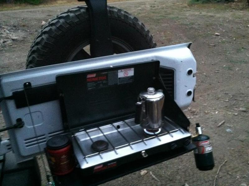

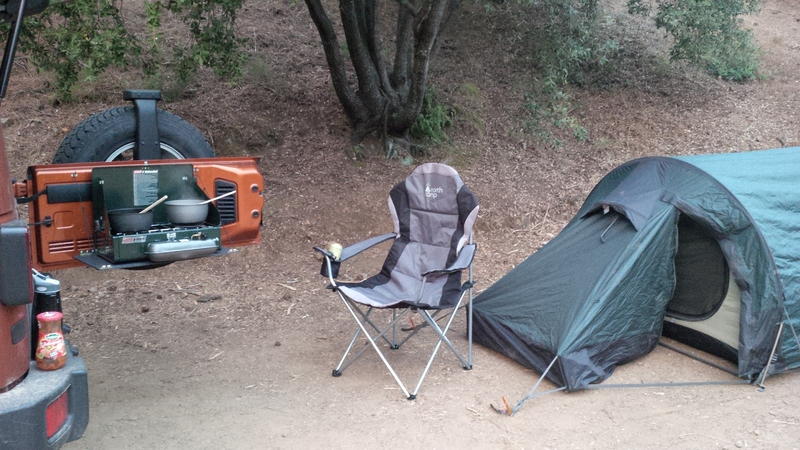

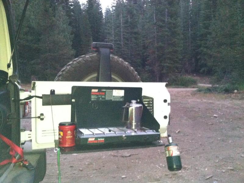

It works pretty good. I need to change the parachord out for chain or cable because its springy but otherwise its fine. I use a bungee to hold it up against the tailgate when not in use. I think I used 1/4" or maybe 3/16" eye bolts.

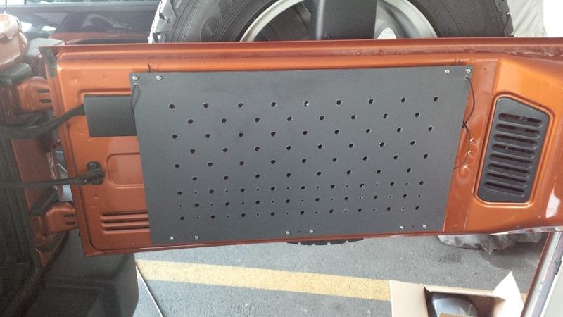

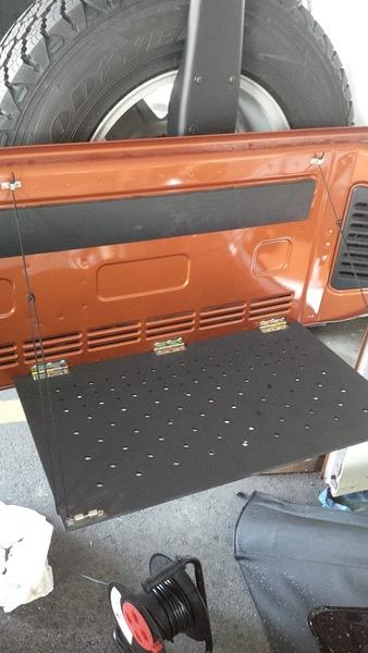

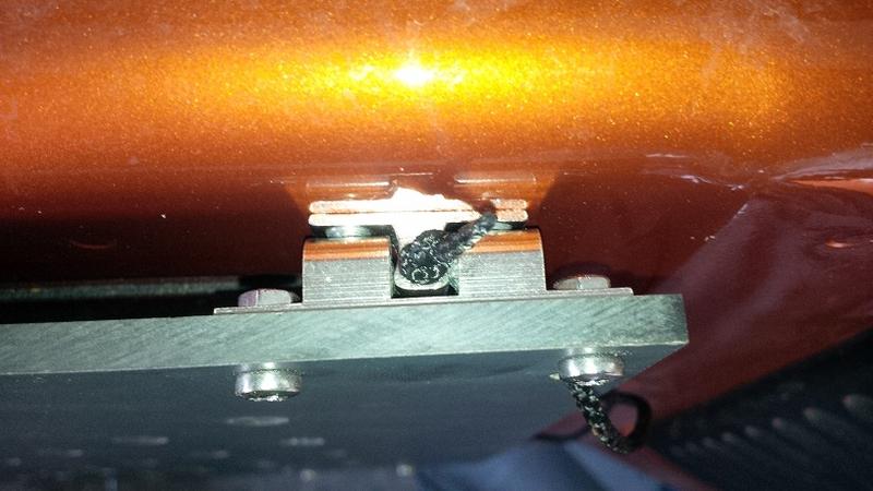

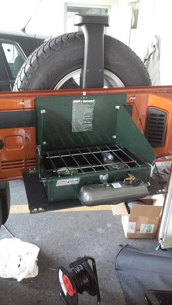

I also made my own. Used ball catches to lock the table when not in use.
ID:	578462Click image for larger version
ID:	578463Click image for larger version
ID:	578464Click image for larger version
ID:	578465Click image for larger version
