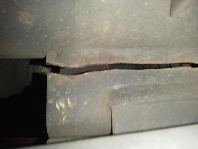

i bought a 2008 sahara unlimited tword the end of 2008. first jeep i've ever owned. bought it from the dealer with a fabtech 3" lift. the dealer had the local tire company intall it before they took it into a couple of paraides, then they put it on the showroom floor for sale. i've been the proud owner of this jeep for the past 3 years. untill i started to wounder about it's integraty.....
a year and a half ago i was pulling into my inlaws house and noticed i couldn't make the easy left hand turn. i thought it was a little strange at first untill i picked up my daughter and began heading home. no sooner as i pulled out on to the main road and begining my left hand turn to go home, the ESP light was going cayzy and i was unable to steer my jeep. i nearly hit a jogger before i was able to get any responce from the steering wheel. luckly i managed to get to an area to ten point turn around and crawl back to the inlaws to investigate. it turns out the front swaybar mount broke at the factory weld to the axel tube. i was heart broken to see her being loaded up on a wrecker to be taken to the dealership to be looked at. dealership said i "hit something". funny...if i hit something that did the damage the dealership sad (ie, broke the bracket, bent the axel, tierods are bent and a larg chunk out of the stableizer) i think i might have noticed hitting something that would've caused that much damage. so after a long battle between the dealership that has my jeep and my insurance company i spent around $1,500 to get it all fixed. i took about a week but seemed like a lifetime couped up in a pickup when the sun was shineing, shoot i could have been driving my topless jeep around.
fast forword to last friday morning. loading up product to take to work for customers. i get to the stopsign and start to take my left turn like i do every morning. i heard a loud bang, and by the time i figured out that it came from my jeep i was entering a curve. once again i couldn't steer and nearly went into the ditch. limped her a block home and scrambled to throw everything into the wife pickup and hurry to work. cusing the whole way knowing it was the same darn bracket again.
called the dealership the fixed it the first time.....they warrent it for a year....figures....
called the dealership i bought it from since i bought the extended warrenty.......doesn't cover brackets.....figures...
called jeep to see if this is a known issue......they are looking into it and requested i take it to the nearest jeep dealer for diagnostics. that was a fun drive let me tell you. break the track bar and hit one of the catch basins that they line the roads with.....talk about a death wobble. i about to call the wife to bring me a new pair of shorts.

Welcome to a very common problem on lifted JK's when people dont used a axle side track bar mount. The factory one is a pile of crap and easily ripped off. Do some searching, you will find it's a very common problem on lifted jk's. There's is nothing wrong with the lift you have per-say.. it has to do with the extra force placed on the factory track bar mount. There's plenty of suspension companies out there that address the problem. Feel free to PM me and i'll show you one of the best options you have

After a lot of digging it turns out the tire company never did the weldng required buy the fabtech instructions. Part is on it's way and should arrive Monday. Hopfuly back jeepin by Wednesday.
