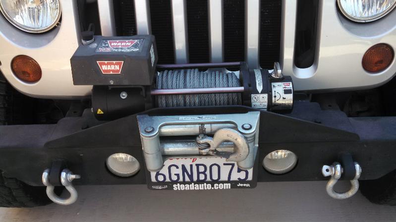

I have a warn vr 10,000 on my jku. It works great.
Its been on my jeep for two or so years now. Still looks new.
