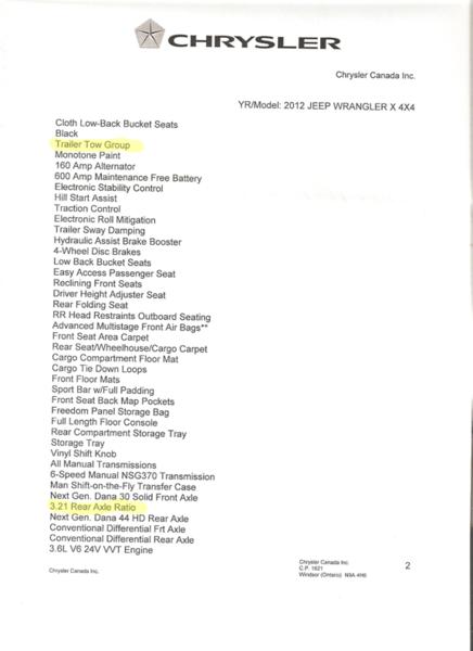

I ordered my 2012 JK Sport 2 drs 6spds in July from Canada. The seller clicked on the 3.73 axel gear ratio option, as it was an option I wanted. He then clicked on the Trailer Tow Group option, he told me the the Tow Group option overides the 3.73 option and said that the 3.73 must be included with TTG. I recieved my Jeep last friday (only 5 weeks after order, yay!) and I noticed that the RPM vs Speed was off for a 3.73. I jacked the Jeep to find out that I got the 3.21 axel gear ratio
I found out that 3.21 works good for me as the Jeep is my daily driver, but losing half of an already quite low towing capacity (2000 to 1000 pounds) makes the Trailer Tow Group I paid for nearly useless now. Where do you guys think the mistake comes for? The seller, Factory or was it just me not careful enough orering my Jeep?

That is a major omission. Get the build sheet and see if it includes the tow package, and see what it lists as the axle ratio.
Also, double check your "jack and spin the tire" inspection, just to be absolutely sure before you call them on it.

Requesting build sheet now
I called Chrysler to request my build sheet. They will send it to me through mail (they won't send emails up here it seems). I don't want to go to the dealer empty handed, so I'll wait for the build sheet to arrive (the lady said from 1 to 2 weeks, awww! an other waiting starts!!).
Thank you for the tips.
