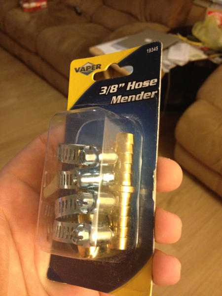

Yea it's a one time deal. You extend them and call it a day. I am planning on running the front one up near the brake booster and the rear to the tail light cavity. If water is hitting your tail lights you have other issues to worry about. If you wanna bring material to do it all you need is a few feet (6-7 feet to be safe) of 5-16 fuel line and a few hose menders in 3/8 (you need two) and you're golden.
This is what I got. Should be enough to do two rigs with a few feet to spare.
http://www.amazon.com/gp/aw/d/B000VZ...sr=8-1&pi=SL75
If someone else wants it done you can just split the cost with them. You can also pick it up locally at like a pepboys by the foot.
And this per Jeep (2 menders, one for each axle)
http://www.amazon.com/gp/aw/d/B0069T...sr=8-4&pi=SL75

Not at all. I was gonna do this anyway, just mentioned it in this thread cause it was relevant. If you want, go buy two 3/8" hose menders and I will bring my leftover fuel line and clamps and you can extend them from 7-9 while we hang out. I got these on amazon for like 7 bucks. I have 25' of fuel line and need probably about 8' so ill have enough left over to do at least another Jeep, maybe two.
Attachment 427632
Check where the front axle breather attaches to the diff. Seems some of the later model JK's do not have a clamp on the hose there. Mine doesn't & got water in some time between Thursday & Saturday nights. Make sure to raise your transfer case & tranny breathers too.
