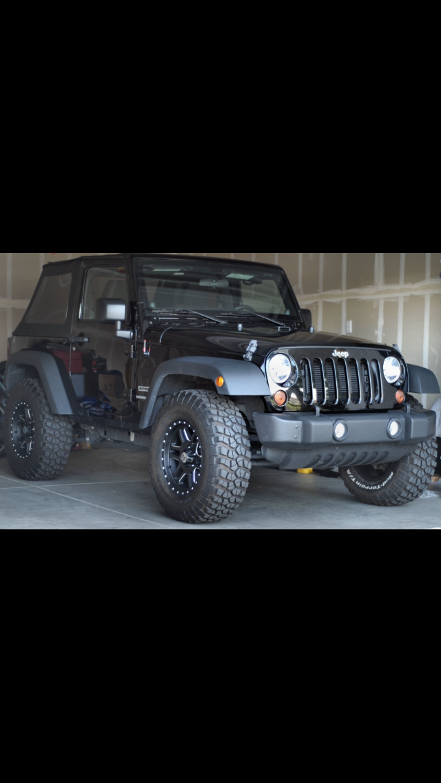

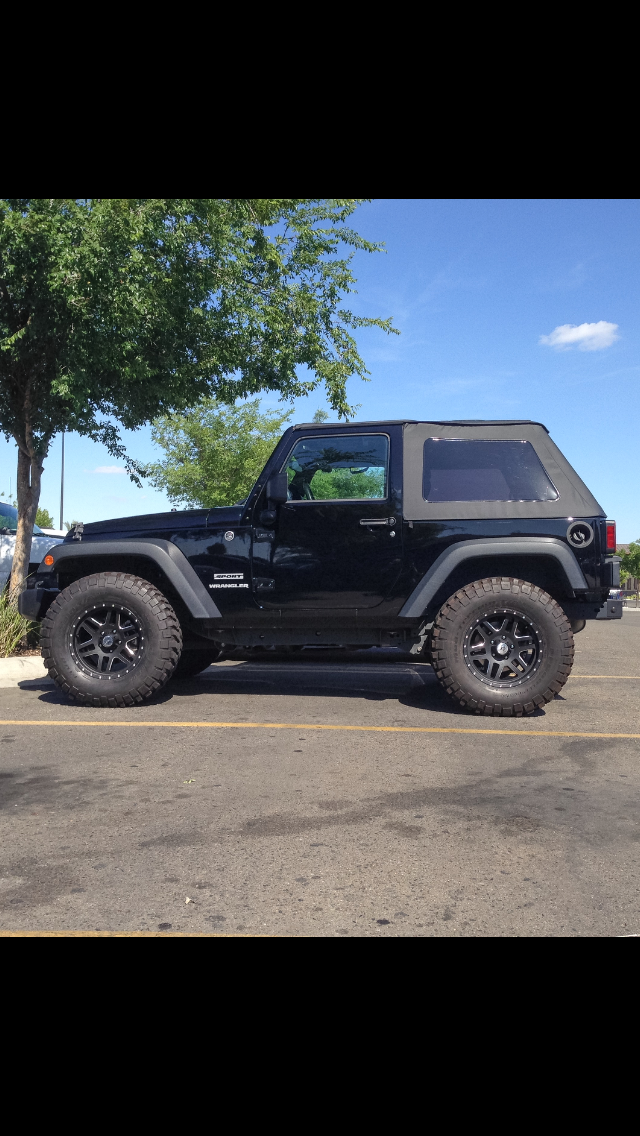

If you want 34" tires try this, I put on 305 70 17 BFG km2's with American Outlaw Marshal wheels with 5.70" backspacing and no rub full lock. Tires stick out only about 1/2" beyond fenders. No lift other than 3/4" spacers up front that cost only $150 installed and took them like 30 minutes to install. Though I went from the horrific 3.21 gears to 4.56, perfect setup.
