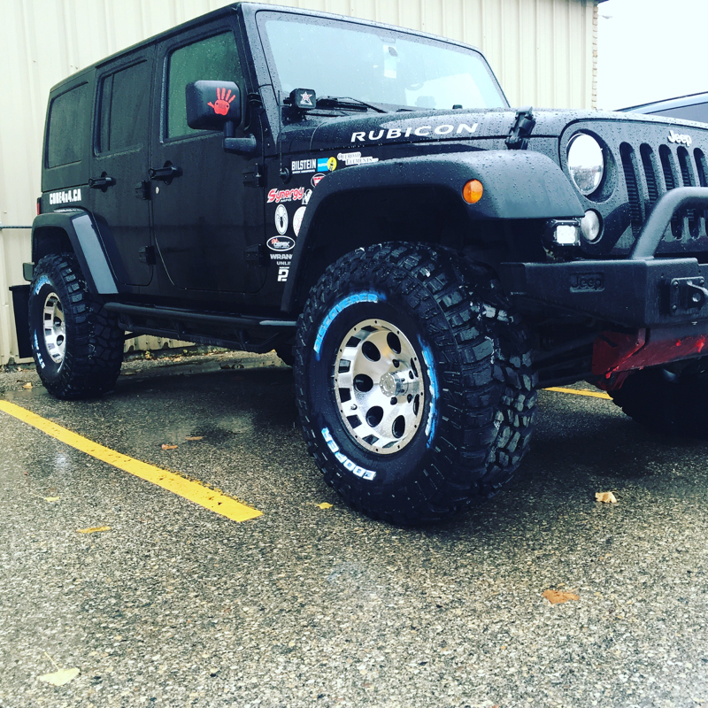

I'm running 15's
And no running discount the direct has a great selection of 15's that fit the jk. And as for lift you have a good 2.5 lift why change for .5 of inch ?
