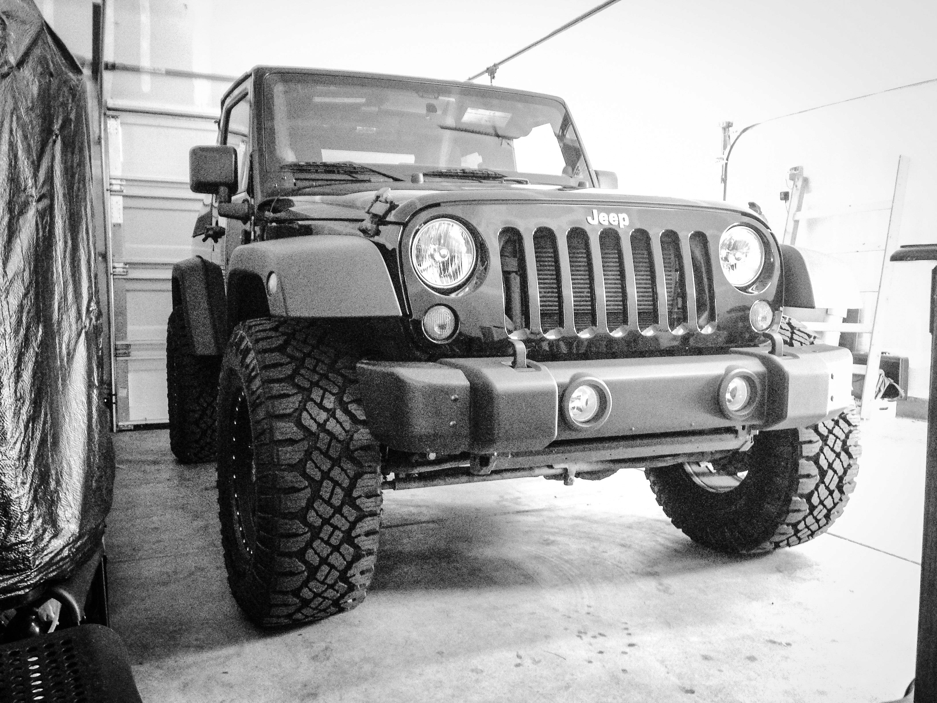

I have the TF 1.5" leveling kit and run 315/70/17 Goodyear Duratracs, American Outlaw Marshal 17x9 wheels with 5.7" backspacing and they still stick out 1/2-3/4 inch beyond the fenders. Great no rub setup, won't stress the axles so much. By the way, regear. You won't regret it as it'll get your power and torque where it should be.

Do you have any pics? Did you have to do any trimming? I have the TF leveling kit, stock rims and 1.5" spacers. Wondering if I could fit same size tires as you
Why YES. You can. Here's a pic. I can drive forward full lock to lock no rub.
