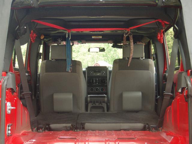

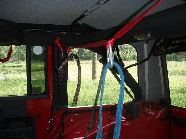

Here's the harness I made to keep the boys in the back when the windows or the top is down. 1-piece of 1" webbing wrapped from roll bar to roll bar. 2-Lockable clamps, 2-old dog collars, and 2-Xlarge -- K9-seat belts.(they were $24.95 each). I wrapped one side of the webbing around the bar, then put a water knot in about over the headrest, then another water knot over the other headrest. Then wrapped and tied it off on the other bar. If you only have one dog, 1 water knot in the middle should do. Then take the clamps and put then trought the water knots. I then found 2 old collars to lower the point of attachment for the dogs. These guys can lay down when they are tired.
