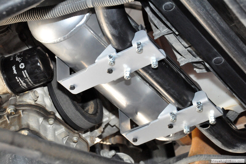

You just need a compressor & tank. I run a 2 gallon Viair tank mounted behind the radiator & a ARB compressor with a 145 psi pressure switch. I have a set of Shocker train horns and my air setup does great for a 7 second blast & takes less than 2minutes to fill. Hers a pic of the tank the ARB compressor is mounted over by the brake master cylinder Click image for larger version

The air tank mount that SF nick is using looks like the Dominion Offroad mount. It will not work for 2012+ Jeeps according to the website. I looked into doing the same thing for my 2012, but Brett from DOR said don't even bother.
