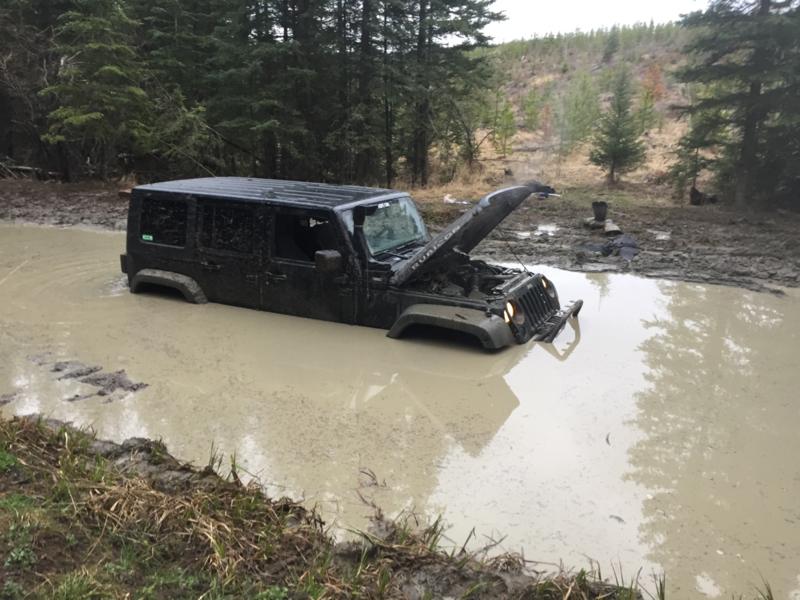

Probably has more to do with your snorkel than the belt. Bearings don't like mud and muskeg. After I tested my snorkel I had to do the tensioner, idler, and a/c clutch bearing.
I'd like to hear your reasoning as to why the snorkel is making bad pulleys?
I didn't read it as the snorkel was the problem itself, but rather the inplication that having it means deep water.... The deep water is the culprit I took away from the comment. (Just my interpretation).
Yep not the snorkel itself just what it's used for. I did my AC clutch and tensioner and idler last fall and it worked great all winter. Went out this weekend and it cost me an alternator, electric fan, tensioner, and idler.
