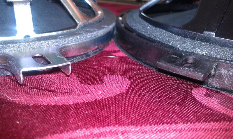

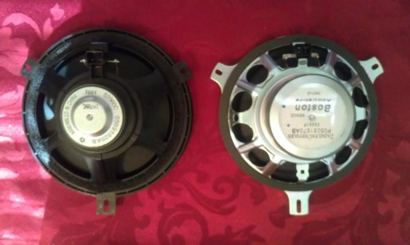

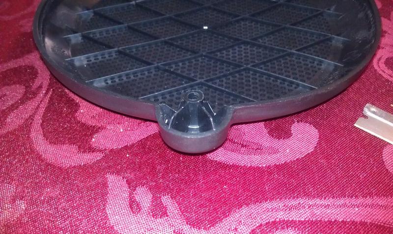

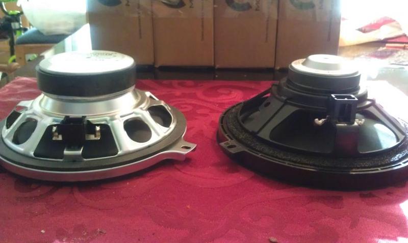

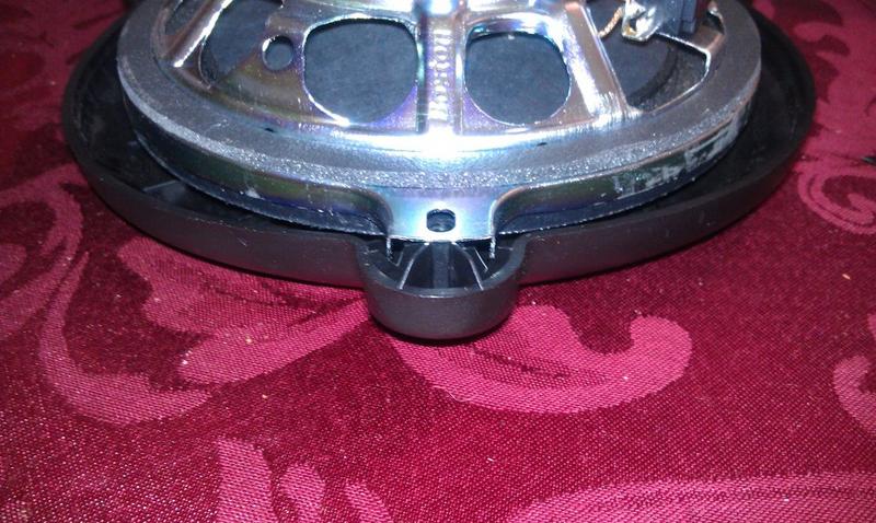

1. Boston Accoustic Speakers out of a 2010 Challenger(5081670AB) 2. Flat Razor 3. Torx Bits 4. Socket Set This was done in my 2012 so there will be several differences for you 07-10 owners. I started by removing the sound bar speaker due to the ease of access. After I had them out you could really tell the difference in quality. Attachment 285269 Attachment 285270 The only mounting difference I found was the different shape of the mounting tabs that caused the speaker grilles to not mount flush. Attachment 285279 To fix this I took a flat razor and trimmed a little off each tab of the speaker grille. Before. Attachment 285286 After. Attachment 285287 |
5 Attachment(s)
After trimming the speaker sits flush like so.

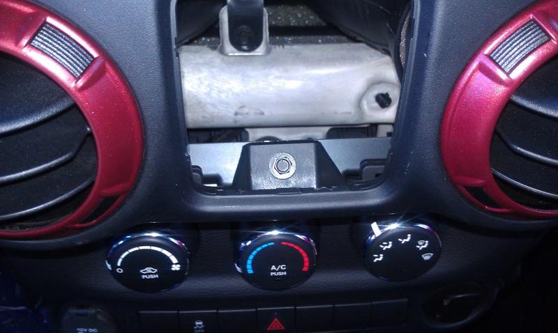

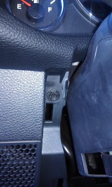

Attachment 285289 Then it is just a matter of pluging them in and mounting them back in. I decided that while I had the grilles off I would color match them to my exterior color, but that was just my preference. Attachment 285290 Now we get to the fun part, taking apart the dash. This would take me longer to teach you how than it took to do it, so I will just post a couple of pictures of the bolts you will need to remove. Attachment 285295 Attachment 285296 Attachment 285297 |

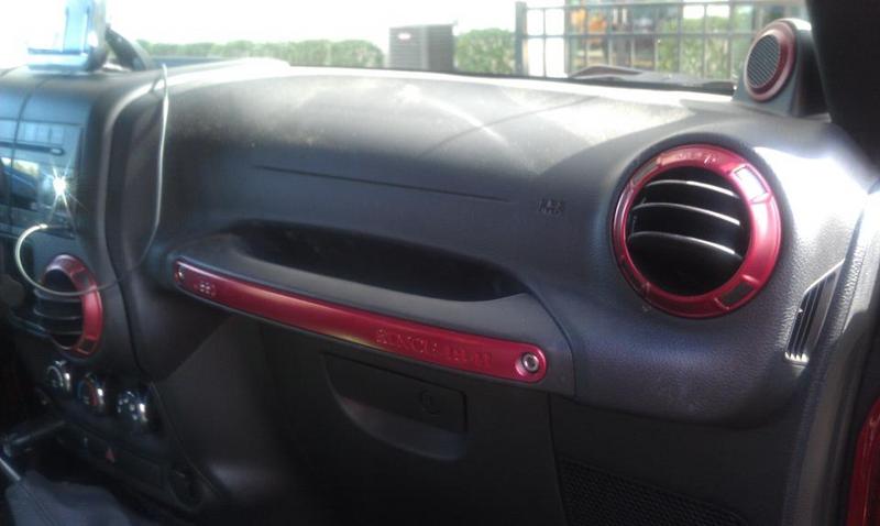

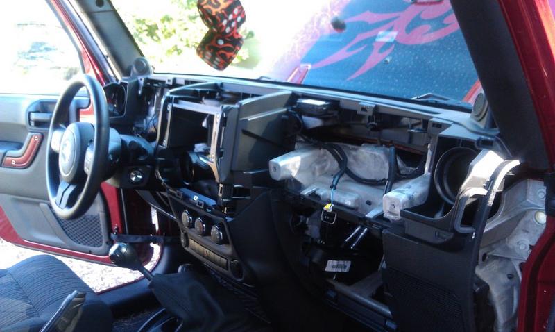

This was what it looked like in the final stretch.
Attachment 285301 Alot of work but the sound was worth it. I would definatly recomend this to anyone wanting better sound. And this is it all put back together. Attachment 285309 |
