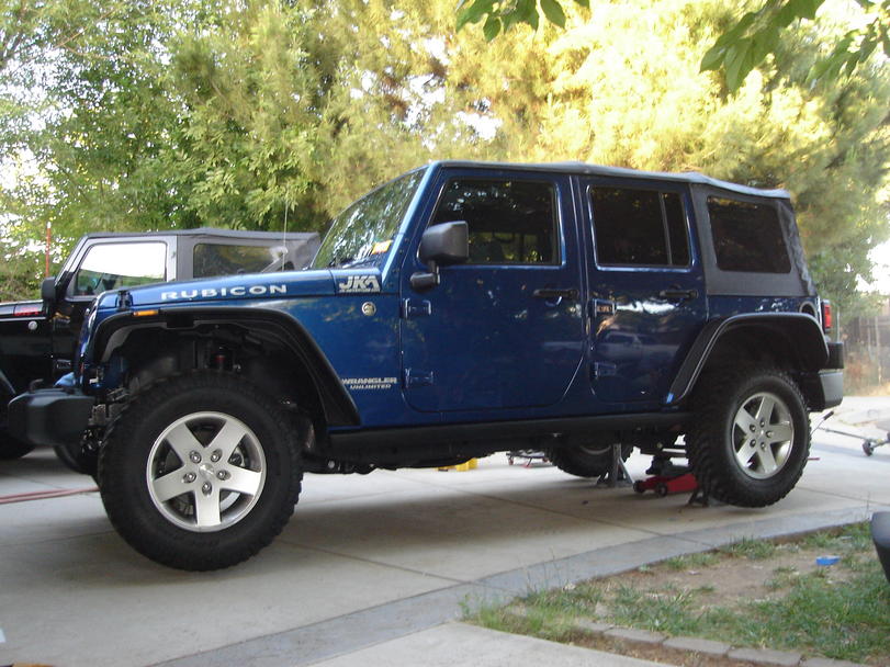

Thanks fourXfour... wow, looks awesome. How was your install? Time, difficulty, broken bolts? LOL What else have you done to your new Rubi? Is that stock suspension so far? Are you looking to go bigger with tires? Once again, looks awesome!

I bought 20 of each and plan on returning the crap bolts to bushwacker. It wasnt too difficult to install keep in mind of the hints from the OP.
The Rubi is my Wifes. Currently running stock suspension. I am doing research for a prototype coilover setup on it.
My JK is a little black 2 door
