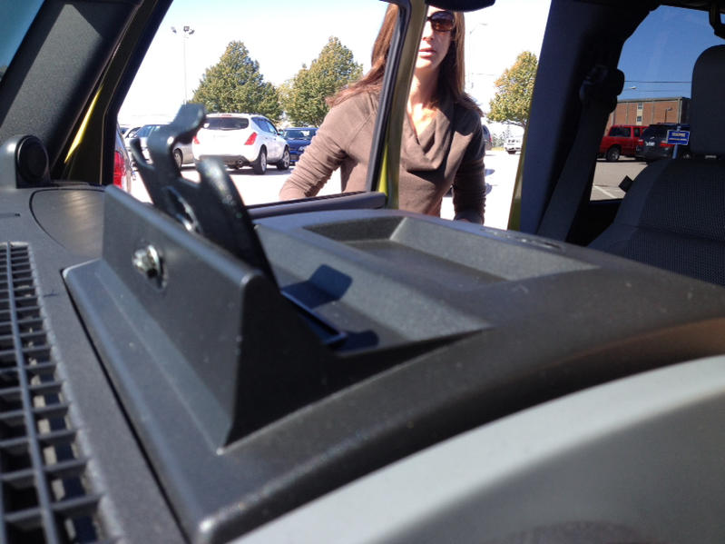

So I picked up my Jeep a few weeks ago... I had an Escalade before... which is a very nice 400hp couch on wheels, but as we know not nearly as fun as a Jeep. So the Caddy is gone and Fun is in! The Jeep is a 2007 Rubicon Unlimited.
The first thing I needed to do is find a place to mount my iPhone. I use my phone for everything... Personal, work, GPS, maps/topo, etc. I have a magnet mount in all my other cars... but the Jeep needs a more secure mount; so when we're out in the woods it can't fall off.
This is what I came up with... the design might change as time goes on but for now this is it:
I made my own bracket out of aluminum and use a Rokform case and mount. Works perfect... Only took about 2 hours to make.
I made the bracket out of scrap aluminum I had (cut and shaped the aluminum with a Dremel). Once I had the basic shape I bent it to match the contour of the dash. I painted and textured it to match the dash. I picked up the allen bolts and washers at the hardware store for $4 bucks.
Once it was ready I mounted the Rokform mount to the bracket. Then I riveted the bracket to the dash. The Jeep could roll over and its not coming off
This is the case I use.
iPhone 5/5s Case with Bonus Car Mount | Rokform
If anyway has any questions just let me know.
