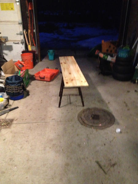

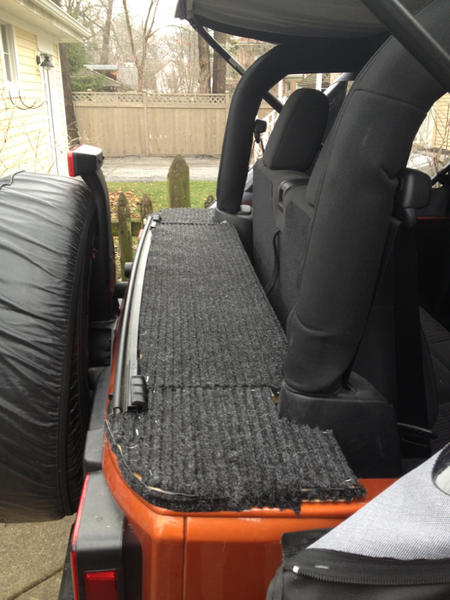

Here are a few pictures of how I covered up my trunk. The seems are really visible in the picture because I wasint done nailing everything down tight but they arnt visible in person. It is relatively water proof and goes around the edges really snug so that my subwoofer and amps don't get a lot of moisture. I also had to use the carpet in the picture which is actually a runner instead of matching the jeep carpet because they were sold out. I may replace it down the road for better matching but I don't really care for now. If you have any questions I'm game to answer them.
