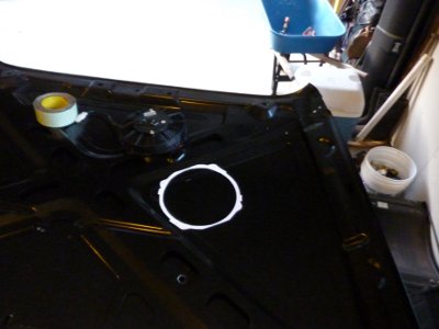

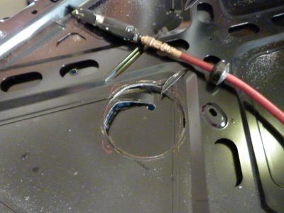

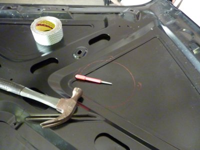

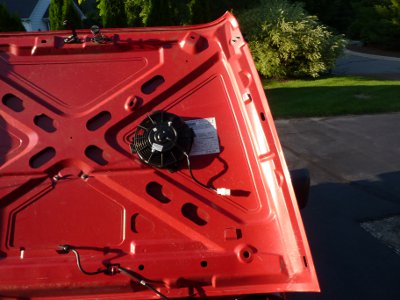

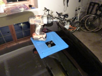

First figured out a good location for the fan
Then cut a paper template from the fan
Tape the template to the hood and trace around it
Then with a punch mark the hood so you can drill the hood from the top down
Tape off the hood and using a body saw cut a 7.5” hole in the hood and drill 4 bolt holes. Next I painted the areas of the hood that were cut and drilled.

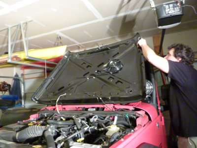

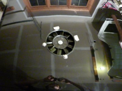

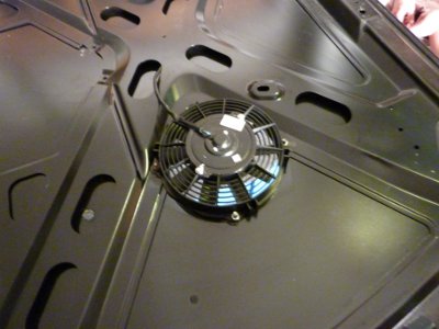

Next mount the fan I used double sticky foam tape on both side of the hood to create small cushion and put the RTV in the holes. I also took some edge molding a put that around the 7.5” hole.

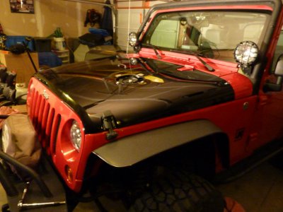

There is some room to mount the peel and stick scoop so measure and make sure you can flip the hood over and it will clear the windshield.
Next I hard wired it in to a switch on the dash so I can control when it turns on. I routed the wires through the channels in the hood and used some wire loom I had laying around.
After I installed the fan I also ordered a Superchips programmer and adjusted when the thermostat fan would kick on I changed the stock settings to low at 200 Med at 205 and High at 210. On the trail you can really tell the difference and with the thermostat adjusted and you hear it change from Med to High and then kick the hood fan on the radiator fan quickly shifts from High to low and the off.

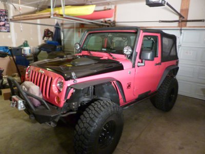

nice job. Have not seen anyone come up with that idea. Is that color pink or pic just off. Did not know they made pink.

Not pink just bright works lights.
