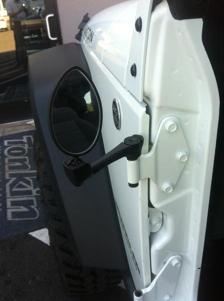

Now all that was left was to put it all together and make sure I did it right.
I did this all with a Leatherman and only cut myself once. And...now I can see behind myself when driving and...parallel parking.
