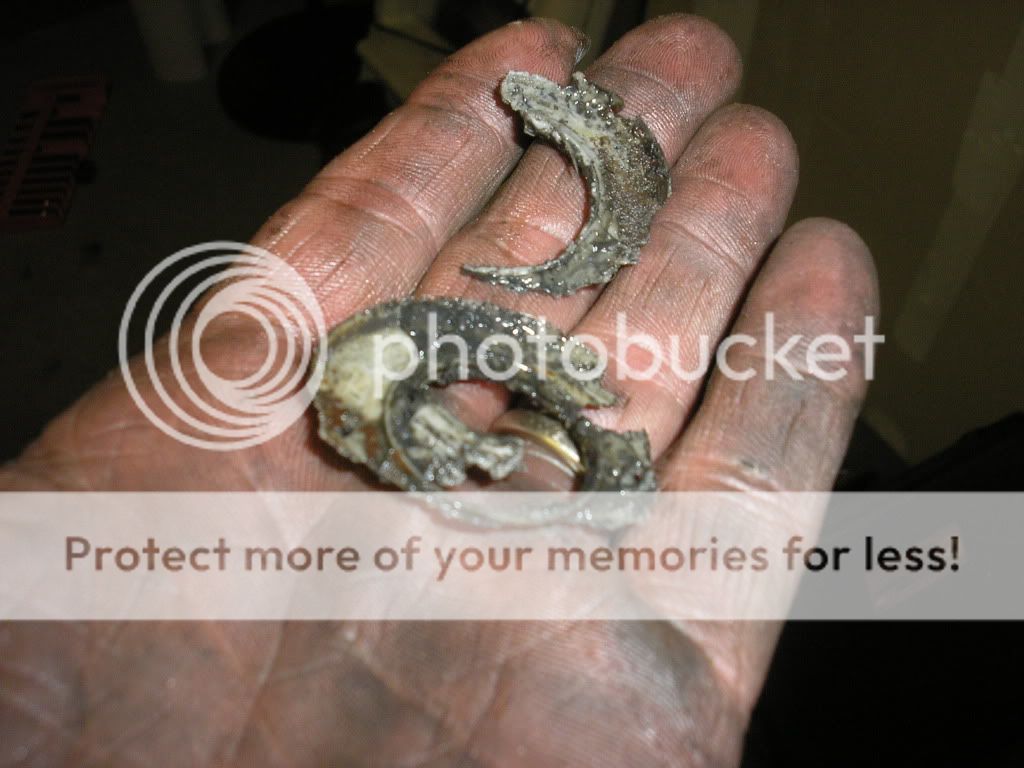

[QUOTE=bondsy;1822693]This is why I had to do what I did.
If I were you I would mail these tore-up-from-the-floor-up OE joints to Chrysler CEO Sergio Marchionne himself with a note: "This is why your company went bankrupt"
