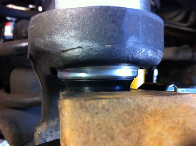

I also had problems with the axle being off to one side no allowing the tool to sit right. I was on a hoist, to get around this i put the front axle down on stands so the springs sagged to ride hight and centered the axle so for anyone is doing this put the axle stands on the axle not on the rails and you'll be fine.
I also put a seal in between the upper ball joint and the knuckle, Its a U Cup Seal - U16. I cut some V's into the inner lip (pictured) before install to allow grease to pass.

Originally Posted by vans
... also put a seal in between the upper ball joint and the knuckle, Its a U Cup Seal - U16. I cut some V's into the inner lip (pictured) before install to allow grease to pass.
Brilliant touch! I notice that the top balljoint is greasable, but not the bottom ball joint? How does the lower ball joint stay lubricated?
Thanks! The lower ball joint has a needle type grease point. I bought an adaptor for my grease gun that works perfectly. Pictured
The grease needle snaps via a standard grease nipple, the sleeve you see is hiding the grease nipple. The sleeve helps to keep it all straight when you're using it.
