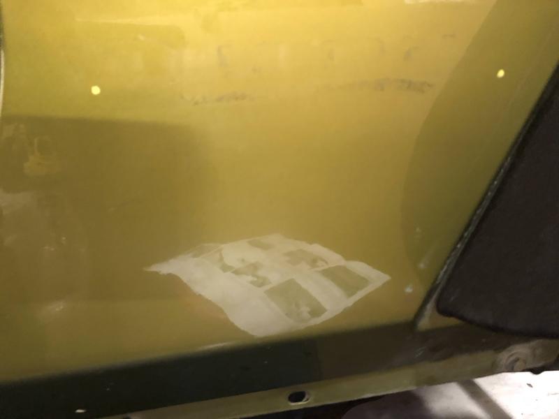

Before we begin, if your Jeep has any running boards or rock sliders, begin by removing them and setting them off to the side.
To install the rocker guards, first locate and position driver side rocker guard onto the Jeep. Using the holes in the rocker guard as a guide mark the side of the Jeep. (You will need the help from an assistant to hold the rocker guard in place.)
The second step we did is remove the rocker guard and set it aside in a protected area, so it won’t get damaged. Center punch the previously applied marks for the drilling and carefully using a 7/16 drill bit drill the marked holes.
