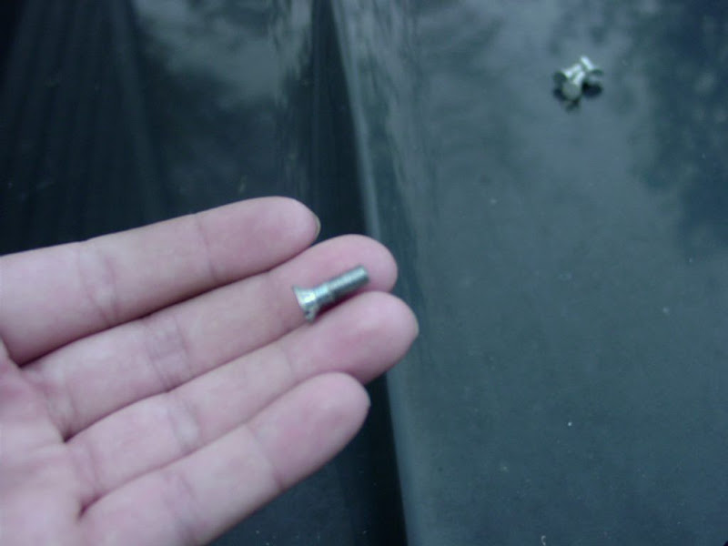

And some screws to fit it which I cut down in length so that they'd fit with out having to drill all the way through the light mount:
Now, I mounted it rather high so that the tail gate can close without pushing this thing against the rear soft top window, incase its ever closed while I’m using this.
Once you drill your holes based off the mounting plate, tap them or you can come in from the other side as well and use bolts and nuts. If you do decide to tap them like I did, make sure you tap them parallel to the plate and not the light mount. The light mount has a slight curve to it so your screws will be crocked when going in.
