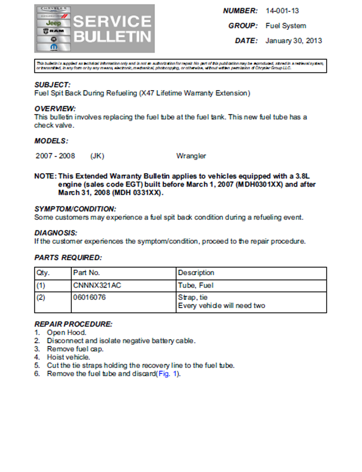

Before you begin... your Jeep is most likely covered under the "Lifetime Warranty Extension". This is not the same thing as the Lifetime warranty offered for new Jeep owners. Even if you did not buy the Jeep new, you should be covered unless certain circumstances (like mine) are present. So, check with your dealership first to see if they'll do this for free. Here is the TSB (Technical Service Bulletin) for the repair:

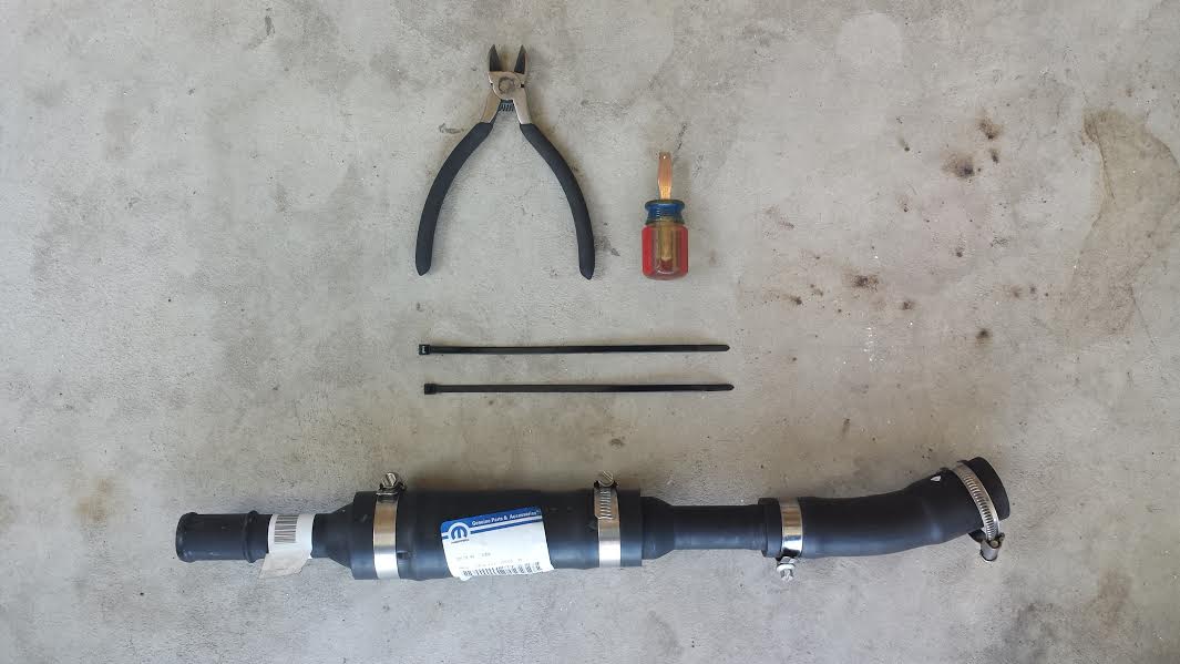

What you'll need... A pair of wire snips, a stubby Phillips screwdriver, 2 zip-ties, and the new fuel fill tube (part number CNNNX321AC). The TSB calls for 2 "tie straps" part number 06016076 but these are simply zip ties.

Place your tools and parts in front of the driver-side rear tire (this will make it easier to grab them).

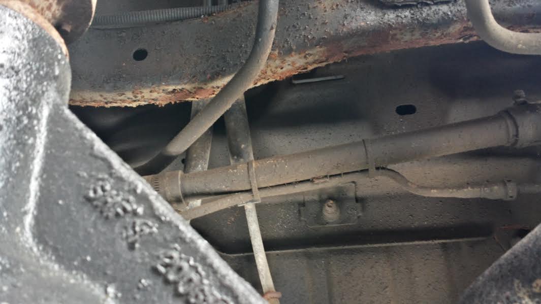

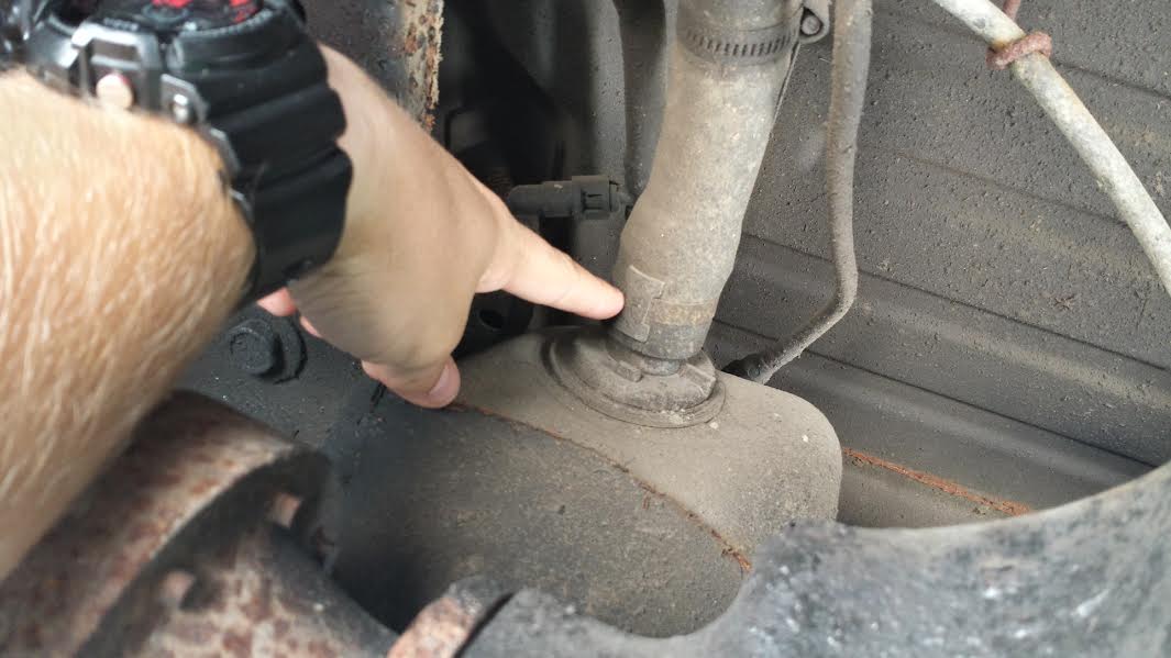

The part we are replacing sits directly above the rear axle and slightly forward. It runs parallel to the ground and is easiest to access by sliding under the Jeep from the rear bumper. In this picture, you can see the fuel tube, as well as the rear differential. (The fuel tube runs horizontally from the driver side tire to the passenger side tire.)

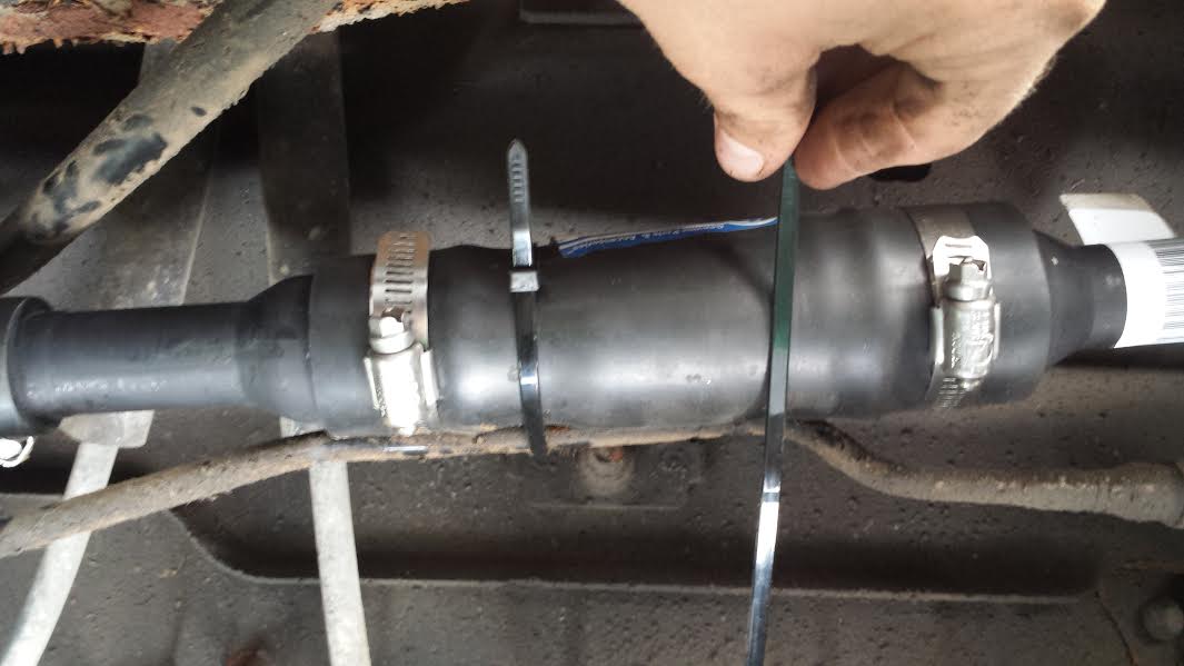

We need to snip the 2 zip ties holding the main fuel tube to the recovery line. Be careful not to snip the recovery line.

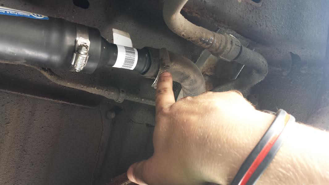

Now we need to loosen the hose clamp that connects the new part to the filler neck. There are 2 clamps that hold the part in. This is the hose clamp on the driver side that needs to be loosened.

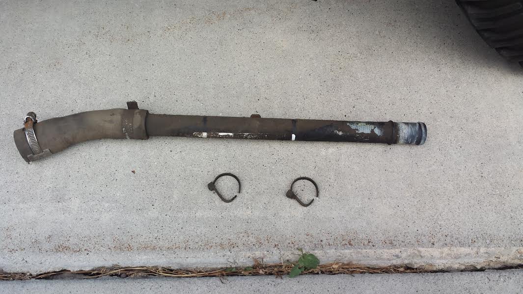

And that's it, you're all done. Here is a picture of the old fuel tube.
