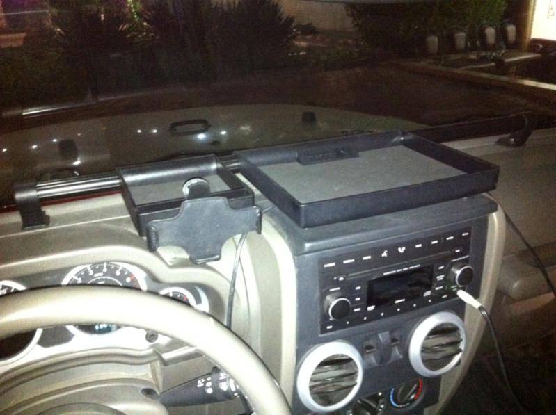

Rugged ridge dash orgenizer .

I don't mean to hijack the thread, but I wonder where the Ipod cable is going in the picture... it looks like they have a regular (non-mygig) head unit... Can the regular HUs interact with an ipod using a regular ipod cable?
You can get a u-connect module for some of the non-mygig stereos. It plugs in the back, which is where the dock connector cable is going.

What Daystar doesn't tell you is that when you put your cell phone, GPS or anything with a battery on the tray, it WILL affect your compass! I bought the Daystar unit specifically to keep my phone on, but the compass went balistic. Driving straight down the road, it told me I was traveling in circles. The compass pickup is mounted directly to the underside of this panel. The only thing the panel is good for is to hold your sunglasses.
My JK is automatic, so I stuck one of those self-adhesive suction discs in the semicircular void just forward of the shift lever. When I need GPS, I just stick the suction mount on the disc and it stays there until I remove it. I had to file about 1/16 inch off one side of the disc to make it fit, but it's in there.
You don't need the ipod cable. I just run a small 8 inch mini jack to mini jack cable from the AUX in the HU to the headphone OUT on my iPhone 4. The iPod should work the exact same way.
