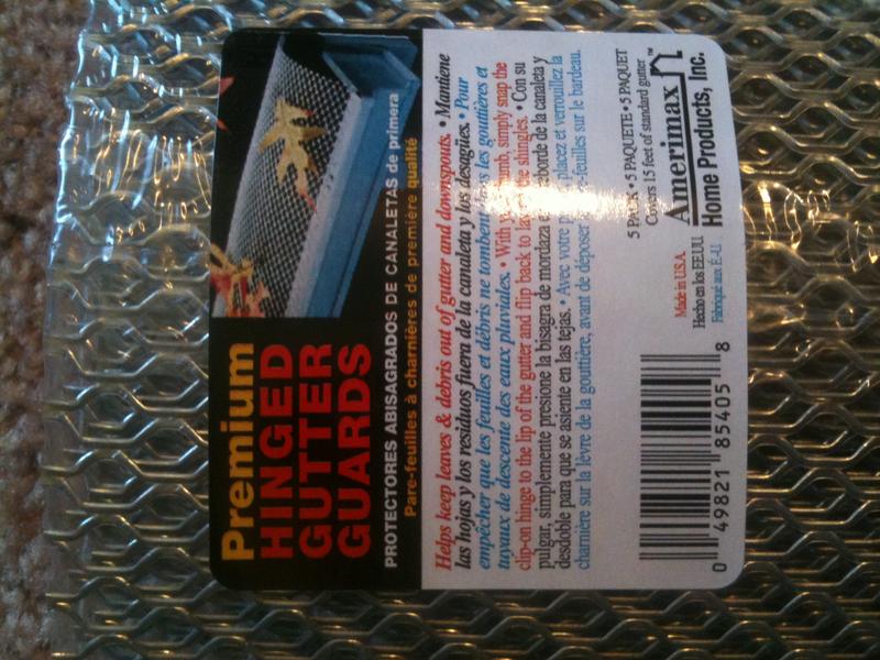

I did this last night. I went to Lowe's, bought 3 packs of 1"x1" zip tie hold sticky things, a pack of 100 black 4" zip ties, Gorilla Glue, and Premium Hinged Gutter Gaurd (Pack of 5, used 2.5).
I took off grill, cleaned the back of it, took it inside and got to work. I laid out all my squares first, then started peeling off the backing of each square and placed a dot of Gorilla Glue on each one as I laid them down.
I let it set for a few hours as I got called into work, losing all the black plastic rivets that I placed on the engine for safe keeping, then started cutting my gutter gaurds to 14".
I laid down the middle section first, then next ones overlapping, using the zip ties to hold down the gaurds.
Items I used:

Some advice: I used block zip tie blocks BUT i peeled off the sticky piece on the bottom and used gorilla glue instead. The first time I did this with just the sticky bottom peice it came off, talk about a PITA... however after re-doing it with the gorilla glue its held up great
