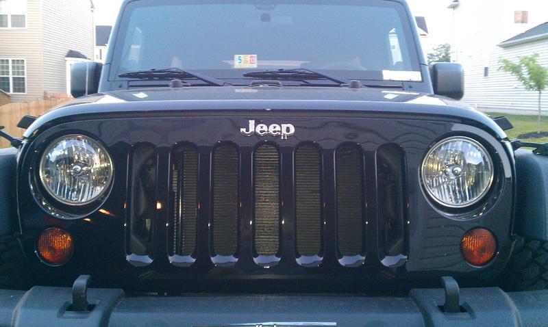

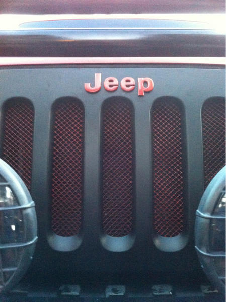

Finished mine yesterday, used expanded metal primed and painted! I like it!
ID:	328766   Click image for larger version

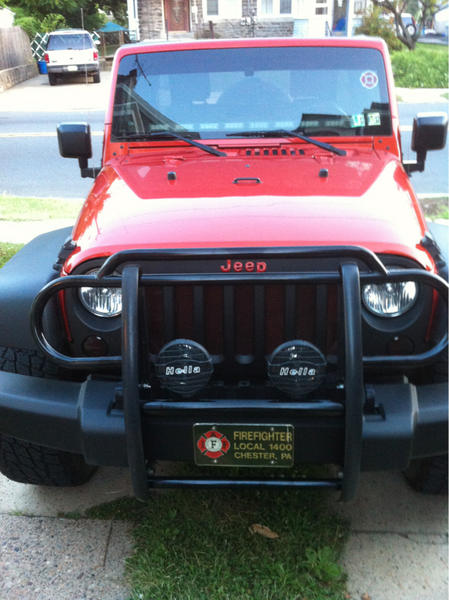

Had my grill rapped & painted the mesh to match my Jeep

That looks sick! I keep seening the Rugged Ridge demo JKs with plastic black grills and want to do this to mine too. PM me if you have info on what paint you used

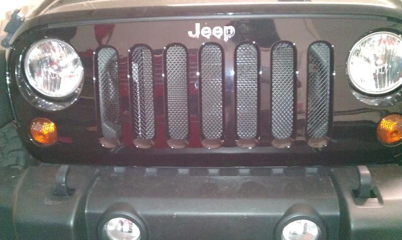

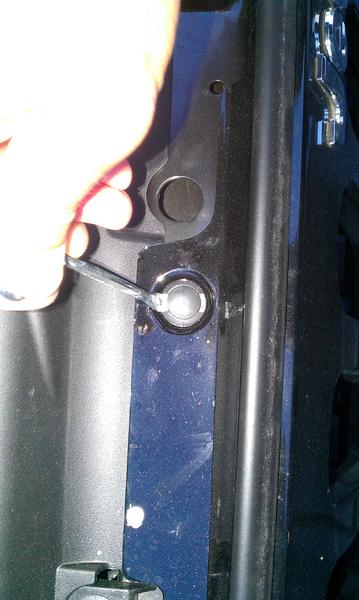

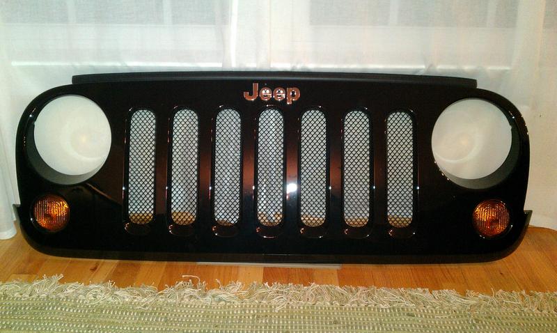

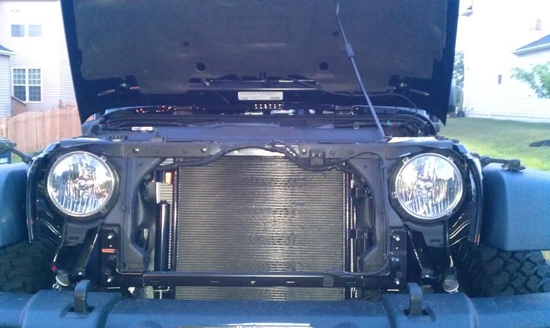

Got around to getting mine done today. Have had the Jeep for just a few weeks, so this was the first mod. Really easy to do, cheap, and looks great. Thanks for all the informative posts. The posts really made it easy. All in all, this mod cost me just under $20.00 - by just a few cents. Like many, I used the roll of gutter guard found at your local hardware store. I soaked the zip tie brackets in Goo Gone overnight. The sticky pads peeled right off in the morning. I then mounted the brackets with Gorilla Glue. To remove the posts that hold the grill in place, I used the thing with which you pry cans of paint open. It took less than a minute to remove all six. Definitely recommend this mod.
