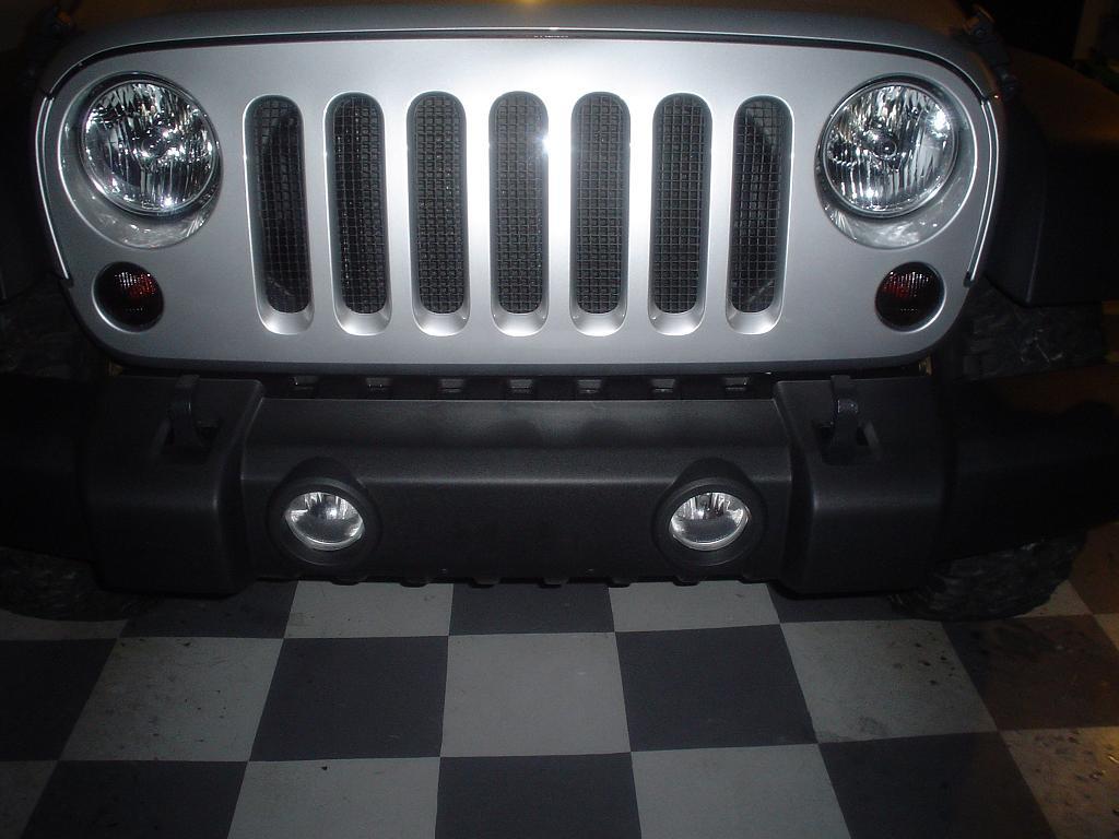

This is my version. I love it, it looks way better and is functional. I used plastic fencing from home depot. I got the plastic gutter gaurds too, but when comparing the two I liked the look of this one better. It is thicker and I think it fit the look of the rubi better. Thanks for the simple mod
