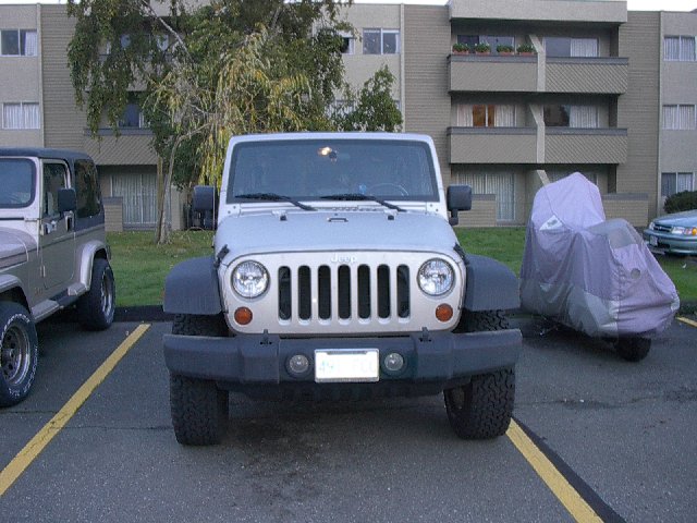

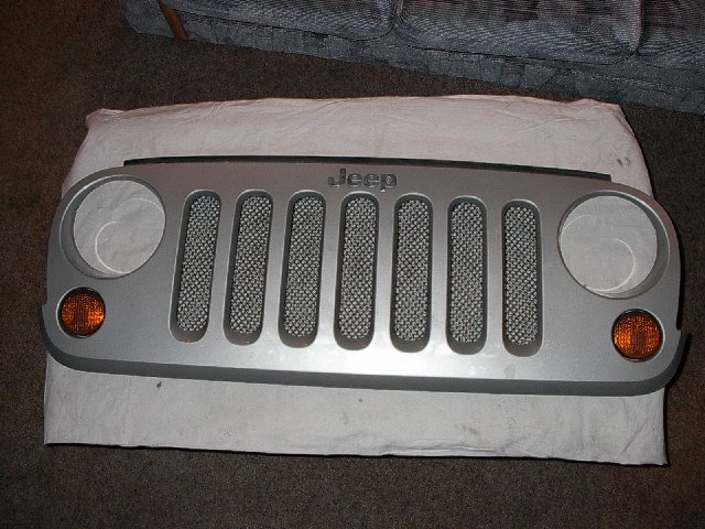

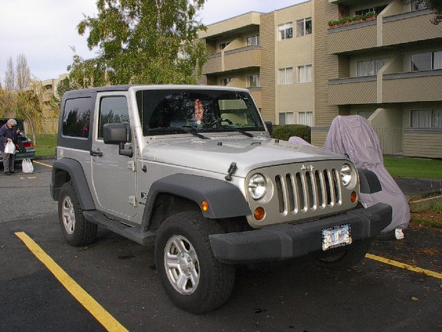

I finally got around to doing both of the Jeeps today, although I did the mod a little differently. I used the plastic mesh gutter guard, but behind that I backed it up with some 1/4 inch mesh painted flat black. There will be no rubbing of the metal on the plastic grill and there is the added strength should a rock make its way to the grill openings.
I did my ladies first, perfected how it would all go together before I did mine!!!
