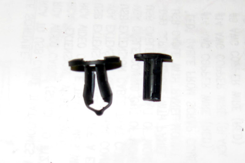

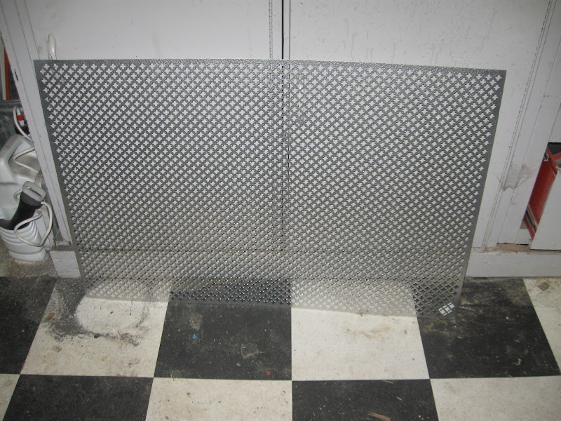

I found using a paint can opener worked well to remove the plastic "screws". For those who are wondering, here is what the "screws" look like:

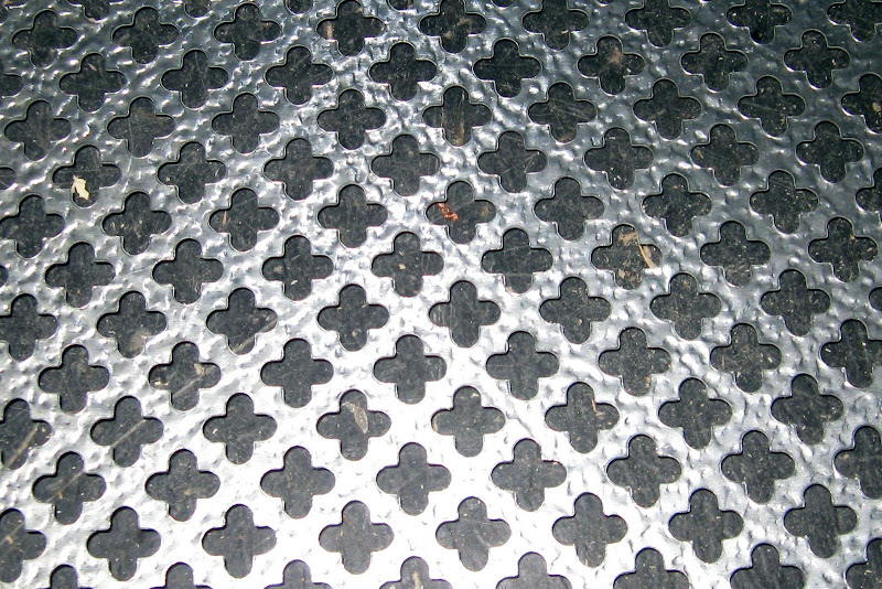

I found a piece of aluminum sheet at Lowes for $25. It was in the nuts&bolts isle by the small amount of raw steel they carry. I figured it was worth a try since it was quite a bit cheaper than ordering from McMaster Carr's like a lot of people do, plus you don't have to pay shipping.
I chose this clover leaf pattern. They had a few different options, but I thought this looked good and will let enough air through.

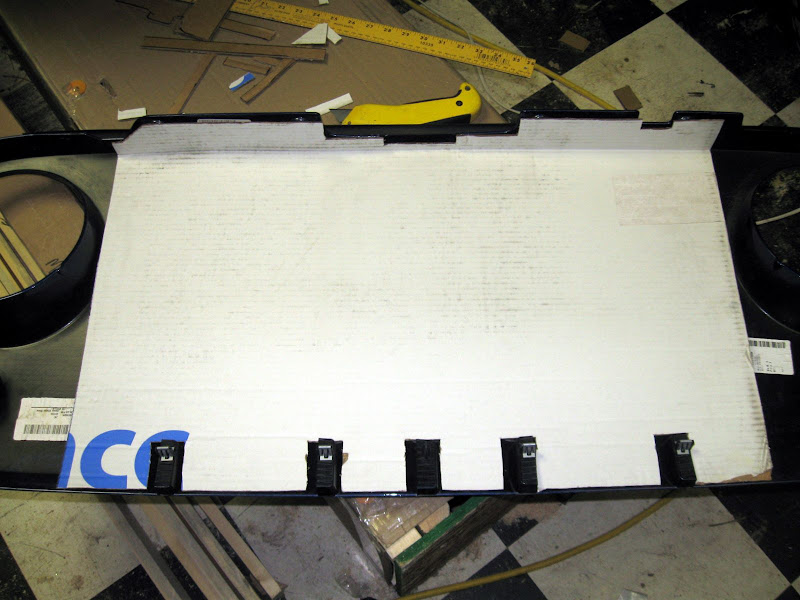

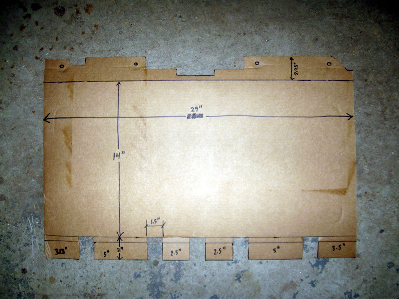

I used cardboard to make a template. Mine "hangs" on the top of the radiator frame where the grill attaches. Basically, it follows the same shape and size as the back of the grill. Here is my template.
Test fitting

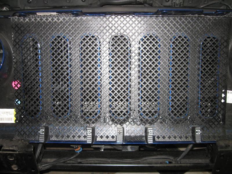

You don't really need to attach the sheet in any way, it will be held behind the grill with the pressure of the grill pushing on it. However, I noticed during my test fit that the sheet tended to bow and create a gap at the bottom of the grill slots. So, I used another popular method to attach the sheet, which is using zip ties. First you get the sticky backs and attach them to back of the grill. I used gorilla glue to attach them since the sticky backing never holds. Here is what the grill looks like. You can see my zip ties holding the grill at the bottom.

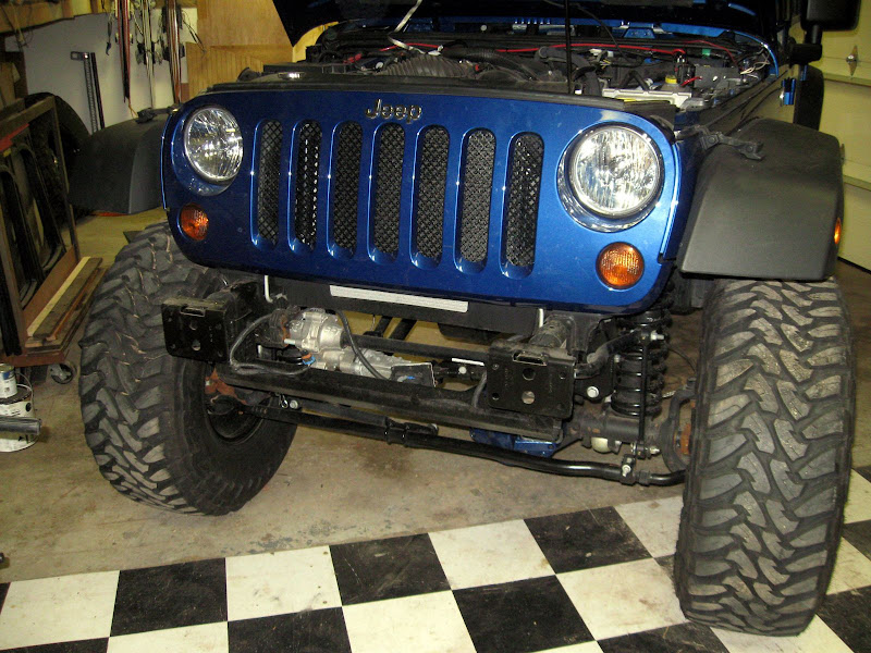

Here is the finished product! You can't quite see what it will look like because I have my bumper off for my next mod...

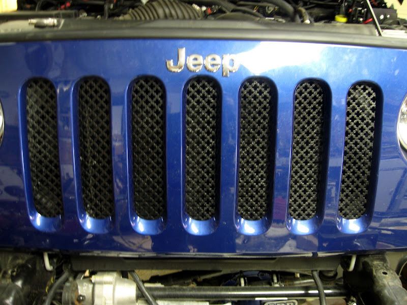

Originally Posted by jerseyjeepgurl
Being as that I was a bit intimidated by finding the right stuff in Home Deopt, McMaster Carr, and others, I found this item in Ebay : 180400905573 and the cost was $46.00 delivered.
In the kit was this:
This was the supplies needed as well in the picture.
The kit came with the mesh grille inserts, the pre-stuck anchors , and the plastic Ty-wraps. I did take off all of the cheapo foam sticky pads and replaced them with heavy duty 3-M double sided Heavy Duty sticky tape.
Then the install, and finished product:
Now it looks much nicer and finished in the front grille area, I think it goes well with the Stainless Bumpers
Thanks for the tip about Ebay. I like it, and it's a good price.
