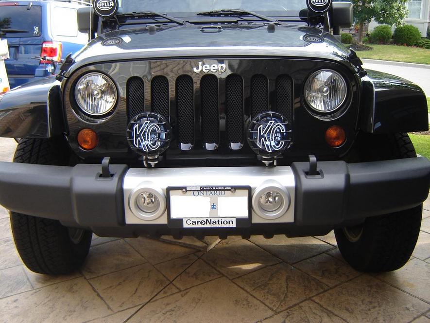

Can't agree more, this is a cheap mod that looks great when done.
I used the gutter guard with zip ties, cleaned the back of the grill area with the alcohol pads before attaching the adhesives - they stick like crazy if the area is clean. Took about 2 hours - very happy!

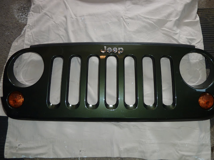

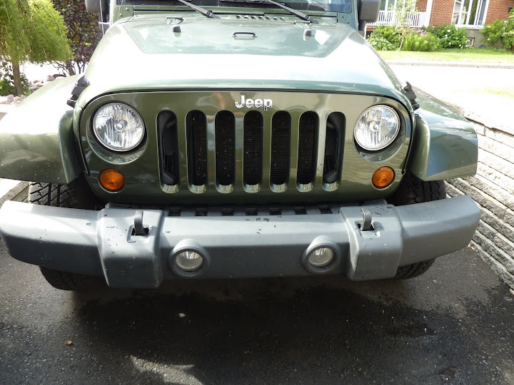

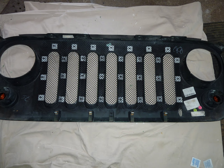

Default I did mine last weekend!
Before:
Grill off:
Backside:
Half-way:
Done! (With Black Tie Wraps ):
Ready to go on:
After:
And the best of all? The wife LOVES it!
Long live cheap mods!
