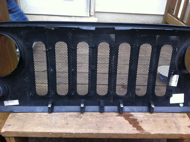

Did my grill mode today. I used plastic rain gutter strip/roll that is available in ACE hardware store. Its already black and no need to paint it. All was needed is to cut each piece (its not sheet its a roll of about 5"wide and verrrry long).
Instead of using 3M tape that is attached on zip tie blocks I decided to get rid of that 3M (as many people complained that it looses greep after a while). The easy way to take off 3M off of those blocks is to boil them for about 5 min and than simply pill them off.
Used Gorilla glue to attach zip tie blocks, though if I'd do it again I would probably go with some super glue type that dries up quicker than gorilla.
The whole process took me 3 hours two of which I was waiting for glue to settle.

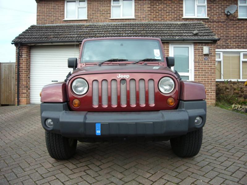

Just added mine, thanks for all the advise earlier in this thread

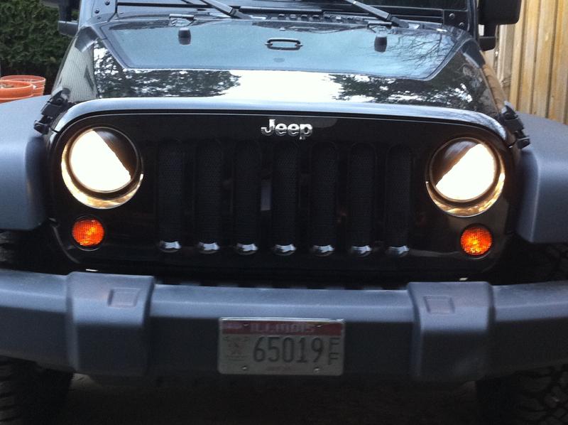

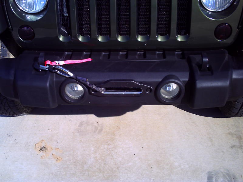

Default Grill mod and angry eyes
Did both of mine todayClick image for larger version
ID:	146222Click image for larger version

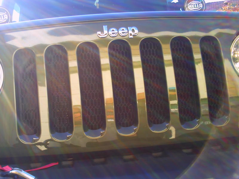

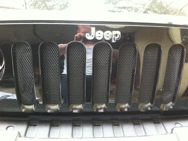

Thanks Davidmech21 post # 433
link to his mod
https://www.jk-forum.com/forums/jk-write-ups-39/grille-mesh-insert-new-method-64142/
