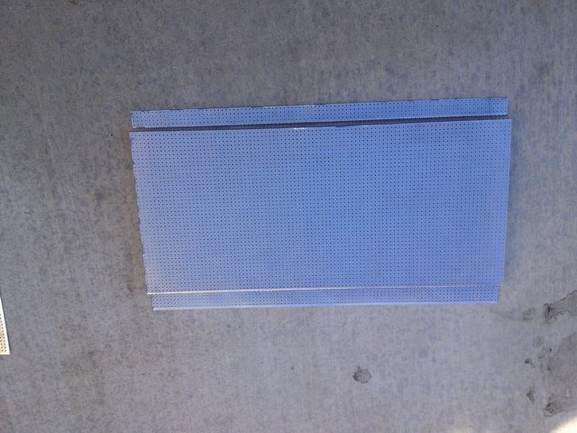

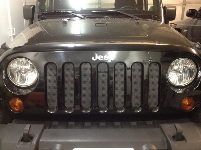

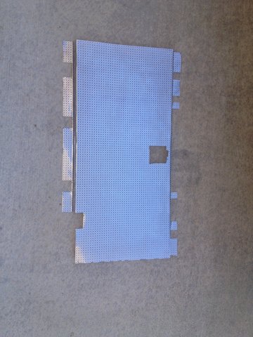

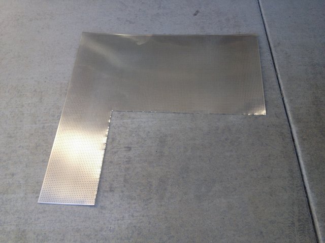

After reading almost all the posts on this subject I decided Brattwurzt's and DavidMech21's idea would work the best for me. I would create a removable aluminum panel that would be held in by the removable factory grill. I purchased a 36"x36" piece of .020 aluminum sheet from HomeDepot. Started by cutting a piece to 27"X17", bending the angles using a 1.5" piece of steel angle iron clamped to a work bench and folding over the sheet with a rubber dead blow hammer and then notching areas for clearance with metal shears. After numerous test fits I was satisfied with the fit, cleaned the surfaces with electrical contact cleaner and applied several coats of dark gray Hammertone spray paint. With the 80*+ temperatures and 10% RH; the paint cured quickly.
Have to give Brattwuzt and DavidMech21 credit where credit is due.....
