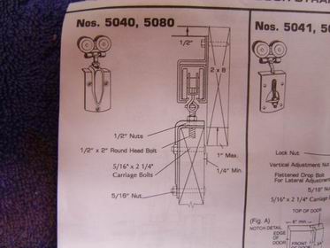

I'd like to know more about this roller channel also - a picture would be great. Was this like a garage door roller channel (vertical roller) or the kind used for a large sliding door? Where did you get the roller channel? How is the pulley system attached to the roller? I'd really like to do a similar sort of thing where the hoist is used to lift the top, but then slid back along the channel to a wall-mounted shelf. Thanks!

I put two rails in because I didn't know the weight at the time (95 lbs). One would channel would probably work, but as an engineer, I like safety factors.
The #10 screws are spaced at 12 inches. You can drill through the channel with a normal hand drill & metal bit. To make it easier, drill a small pilot hole first, then a larger hole for the screw. Please make sure you put a washer on the screw.

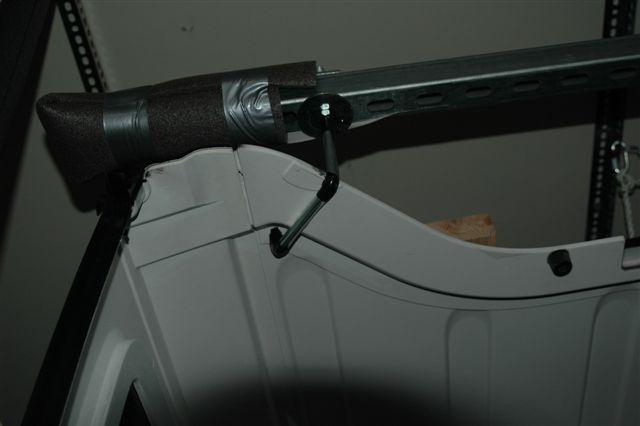

I THINK I've attached a photo showing one of the front hooks in position under the wide lip that's molded into the 2-door hardtop. I'm having trouble getting my photos compressed enough to meet this forum's requirements -- I even emailed them to myself so that Outlook Express would compress them, then tried to upload those versions. I'll keep looking for a workaround on that issue. I don't have any photo processing software on my PC these days.

Here's a few pics. It's actually called a Box Rail. I got it at Tractor Supply Company
http://www.tractorsupply.com/webapp/...g=true&cFlag=1

The attached photos show:
("Front hook") ...How the hooks cut down from U-bolts that Howie developed for his T-bar hoist nestle perfectly into the wide lip molded into the front edge of the 2-door Freedom Top. Once the hooks are tightened into position at the correct angle, it is virtually impossible for the top to slip to the left or right.
