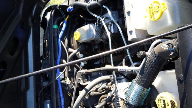

Old Nov 17, 2013 | 04:55 AM
  #57
tribulation138's Avatar
Joined: Nov 2012
Posts: 849
From: CT
Works perfect
