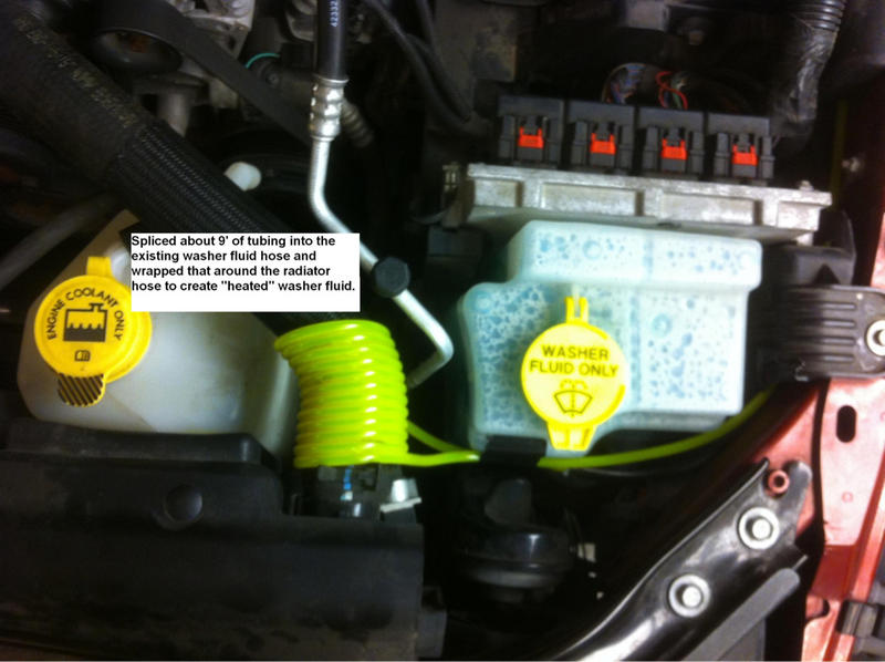

Old Oct 5, 2012 | 06:31 PM
  #38
Otten's Avatar
Posts: 52
From: Rochester, IL
Pic attached
Old Oct 5, 2012 | 06:38 PM
  #39
rinkishJK's Avatar
Joined: Jul 2009
Posts: 4,038
From: NORTH JERSEY
Originally Posted by Otten
Pic attached
<img src="https://www.jk-forum.com/forums/attachment.php?attachmentid=374650"/>
I like the green tube. Nice job. Very clean.
