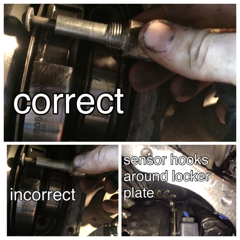

A helpful hint when working with the rubicon from locker: the locker sensor needs to come out after the carrier and go back in before you put the carrier back in. We held the sensor open with a piece of match stick with fishing line tied to it so that it would clear the locker plate. There's a YouTube vid on it that helped a lot. This is important because if you put the sensor in after the carrier it pushes the locker plate as you screw it in and locks the axle. Save yourself a few hours be doing it right the first time. The worst feeling is finishing and then realizing you have to start over. Click image for larger version
Also remember to reattach the dog collar fastener to the same way you took it apart.
