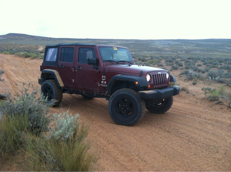

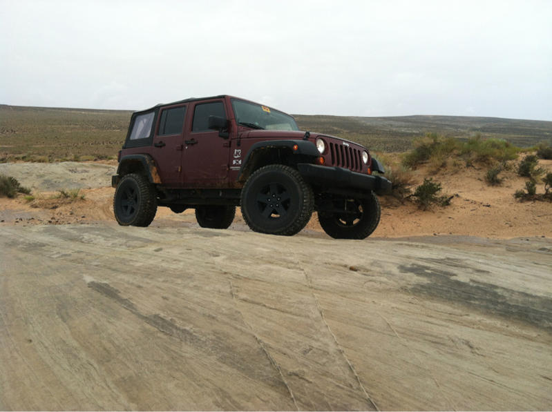

I have been a way from this site for a while, but just noticed this write-up. I used an automotive plastics paint called Trim Black. I have put the paint to the test. Running through shrubbery, sand, mud, rain, windy dusty days, the blazing sun in AZ. They still look great. Like it was already said, your time in your preparation will determine your results. I used a surface prep cleaner and a red Scotch-Brite pad and scrubbed the fenders and bumpers down really good. Then I went around with CLEAN non-fuzzy rags and my cleaner ,wiping everything down really good. (I used this same method to do my stock JK wheels. Dry Scotch-Brite pad though) I deleted my pics of the proccess from my phone, but when I get home I will post up some pics of my results. All of those other options are great and all, but why not just do it right the first time. Watching people use Peanut Butter is pretty damn funny, but thats a desperation move... I didnt use bedliner out of personal choice. The paint I used is specifically designed for automotive plastics. (Dads an ASE Certified Master Collision Repair Specialist. He is who told me about Trim Black) You can get it at Napa. Its a bit more costly, but its better than using edible ineffective products on your Jeep! Lol.. I used a regular semi-gloss paint for the wheels. I think I used Krylon semi-gloss.
Old Aug 29, 2013 | 11:15 PM
  #72
Philip *AZ*'s Avatar
Posts: 518
From: Page, Arizona

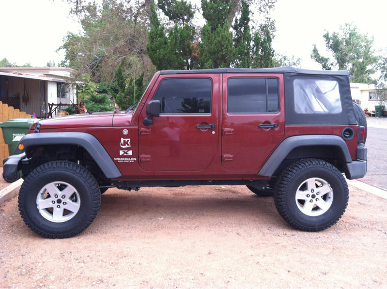

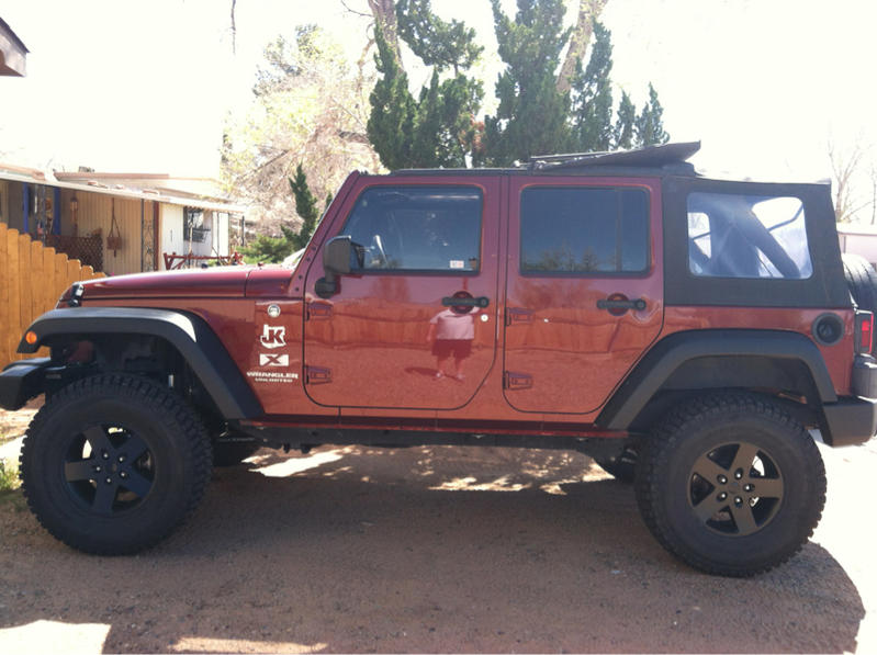

Well, here are a couple I have on my phone. I will post up before and after pics. Its a massive difference, made the Jeep look new again! The first two pics are the best before and after I have until I get home.

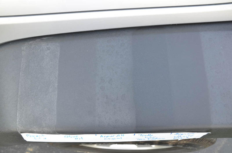

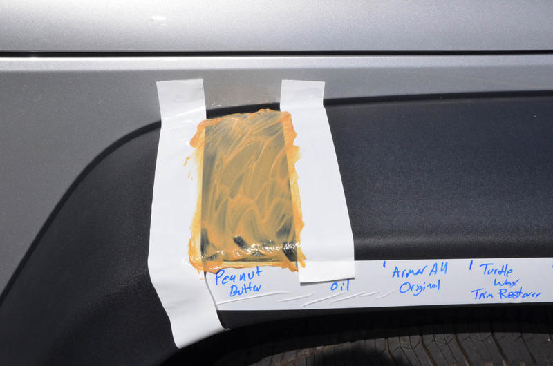

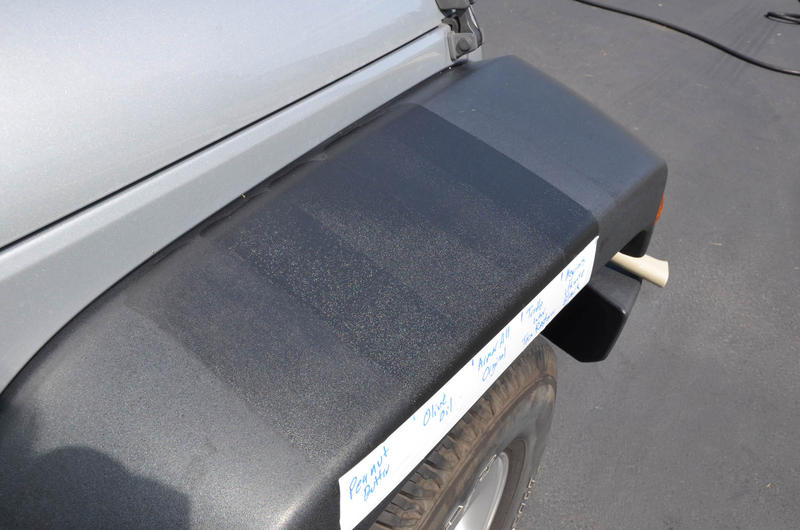

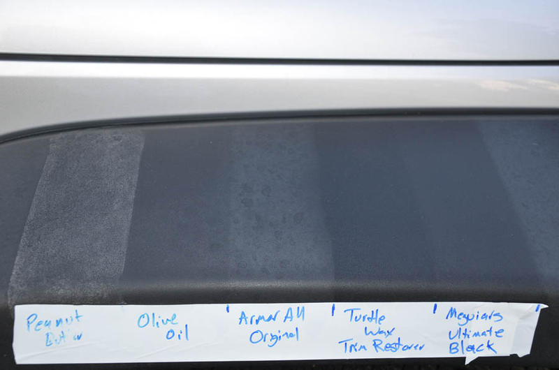

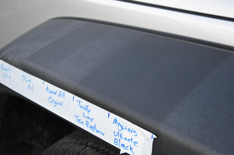

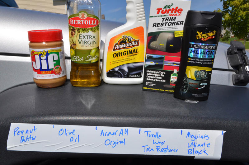

Default Update after 8 days - Black fenders
Originally Posted by valovic
Photos after 8 days
ID:	494281Click image for larger version
ID:	494282Click image for larger version
So after 8 days, the peanut butter looks really bad, the olive oil does not look that bad. It is similar to the Maguire's Ultimate black. The Armor All is gone and is equal to the untreated parts of the fenders. The turtle wax Plastic trim restorer really does look the best.
I'll let it go another week and take some more photos.
Photos after 8 days
Attachment 494281
That's pretty impressive, both in the results and that you would do a test like this.
Thanks for posting what you found.
Photos after 8 days <img src="https://www.jk-forum.com/forums/attachment.php?attachmentid=494281"/><img src="https://www.jk-forum.com/forums/attachment.php?attachmentid=494282"/><img src="https://www.jk-forum.com/forums/attachment.php?attachmentid=494283"/> So after 8 days, the peanut butter looks really bad, the olive oil does not look that bad. It is similar to the Maguire's Ultimate black. The Armor All is gone and is equal to the untreated parts of the fenders. The turtle wax Plastic trim restorer really does look the best. I'll let it go another week and take some more photos.
I'm having Mythbusters flashbacks!
Seriously, though, great way to get to the bottom of things. Looking forward to next week's pics.
Ditto. Mine are faded, plus I have discolored spots from f**cking peanut butter.
